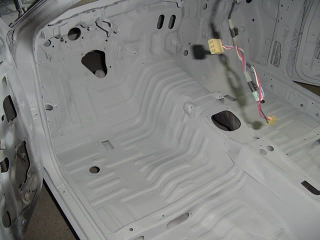

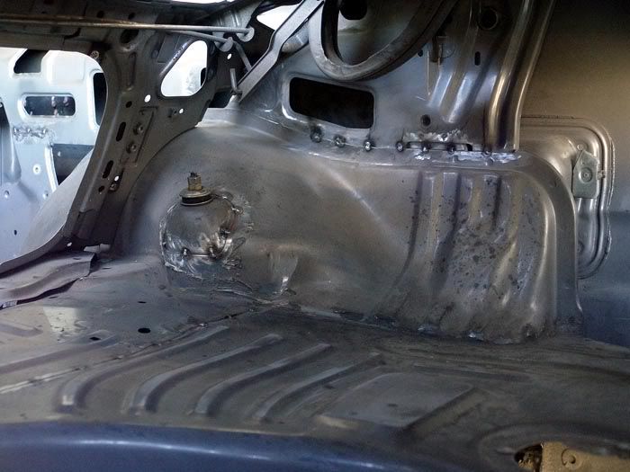

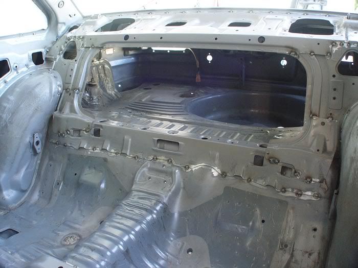

Haven't had a license in a long time so i have time to work on the car. I decided to stitch weld as much as i could and the tedious work of removing most of the unnecessary wiring, and relocating it. the two main fuse boxes that are in the engine bay have been relocated to the inside of the car.
list of eliminated wires include... door jam light stuff, dome light, power seat belts, anything that controls the air circulation cause that has all been removed also, horn blah blah pretty much anything that doesnt control the engine or tail and headlights. oh but i still have my stereo
stitch weld stuff.
electrical stuff
these are all the wires left that run to the back of the car. no more huge mess

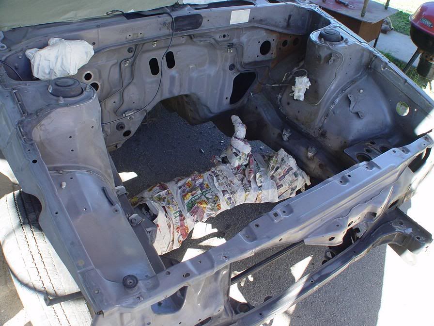

these are the only wires that run into the engine bay. the harness is small enough that i wont have problems on rubbing so i still ran it through here.
engine bay wires end over here at the passenger headlight.
fuse boxes that are usually near the battery and under the intake box. im going to extend the plugs off the engine harness and they will be fed into that big hole above the bundle of plugs. this area still needs to be cleaned up a little. and i need to extend some stuff for the battery that will be behind the passenger seat.
windshield wiper harness now runs in through here instead of over the wheel through the fender well.

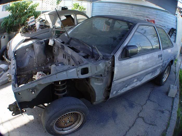

overall shot... some things still need to be cleaned up. most dangling plugs you see are buttons on the dash for headlights. gauge cluster and stereo
older shot. all i want is stock silvia sideskirts as far as exterior goes

What did you paint the interior with? How did you strip the stock sound deadening/paint?

i removed the sound deadening with a air hammer/chisel on a cold night. used that technique for 3 cars and seems to work good. i took the bit to a grinder dulled it down and also taped the end of it with some duct tape. its a very delicate process. i dont actually chisel it off more like just vibrate the metal and it comes flying off. i've done the dry ice and other techniques, but i've figured the air chisel out pretty good and can do a whole car pretty quick.
for the seams i just used a heavy duty wire wheel and a hand chisel and just went out it. this is definitely the most tedious part of the project. there is a pretty huge layer going around the bottom of the rear shock towers. I also cleaned the metal with acetone after that. some day im gonna get a good paint job and at that time ill strip everything and get the whole car sprayed inside and out. but for now its just rattle can... like the exterior of my car.
Originally Posted by McRussellPants
Why did you stitch the seat braces?
pretty much cause i wanted to, pretty simple. its a triangle piece that connects my shock tower to the chassis which is a strong design and i wanted to reinforce it.... you think that structure is only there to support seats ? i doubt that since the coupe has a whole piece that goes across from shock tower to shock tower.. seems like something they had to design for the hatch that wouldn't go all the way across so there could still be good storage room when the seats are down and also add support... im sure that is why they came up with that piece. in addition im sure some cornering forces will be distributed though that piece and now its stronger.
