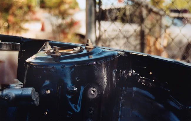

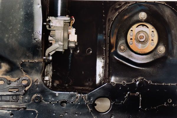

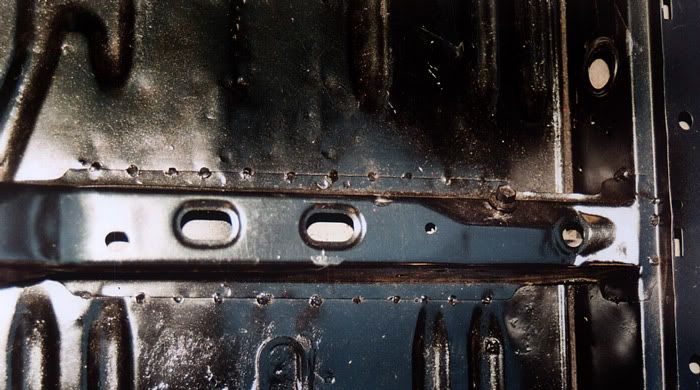

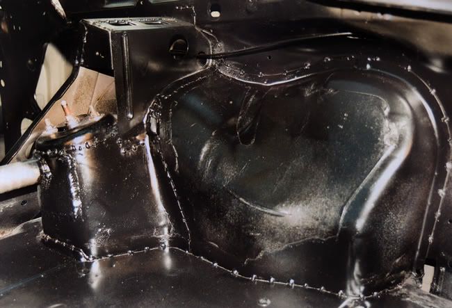

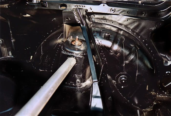

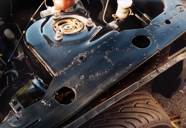

Haven't had a license in a long time so i have time to work on the car. I decided to stitch weld as much as i could and the tedious work of removing most of the unnecessary wiring, and relocating it. the two main fuse boxes that are in the engine bay have been relocated to the inside of the car.
list of eliminated wires include... door jam light stuff, dome light, power seat belts, anything that controls the air circulation cause that has all been removed also, horn blah blah pretty much anything that doesnt control the engine or tail and headlights. oh but i still have my stereo
stitch weld stuff.

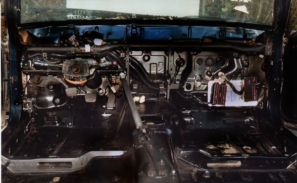

electrical stuff

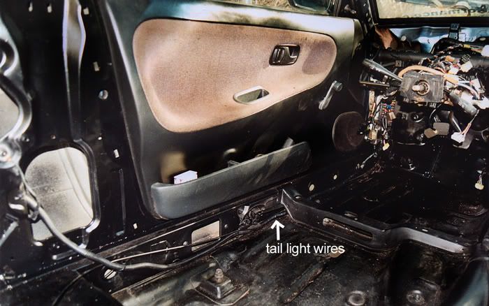

these are all the wires left that run to the back of the car. no more huge mess

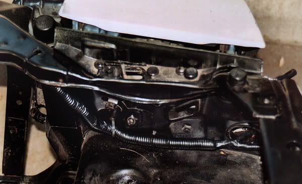

these are the only wires that run into the engine bay. the harness is small enough that i wont have problems on rubbing so i still ran it through here.

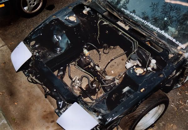

engine bay wires end over here at the passenger headlight.

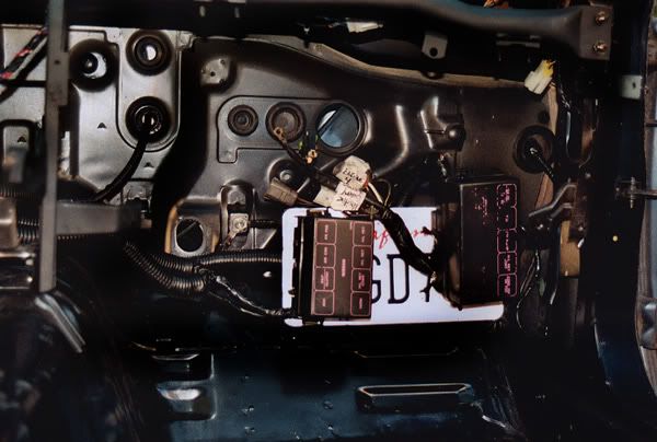

fuse boxes that are usually near the battery and under the intake box. im going to extend the plugs off the engine harness and they will be fed into that big hole above the bundle of plugs. this area still needs to be cleaned up a little. and i need to extend some stuff for the battery that will be behind the passenger seat.

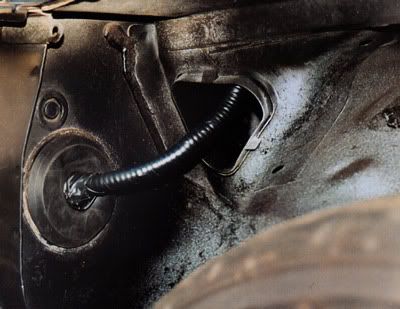

windshield wiper harness now runs in through here instead of over the wheel through the fender well.
overall shot... some things still need to be cleaned up. most dangling plugs you see are buttons on the dash for headlights. gauge cluster and stereo

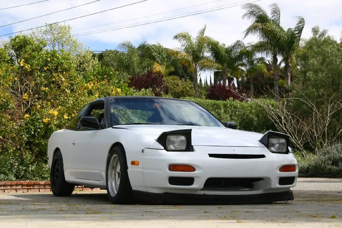

older shot. all i want is stock silvia sideskirts as far as exterior goes

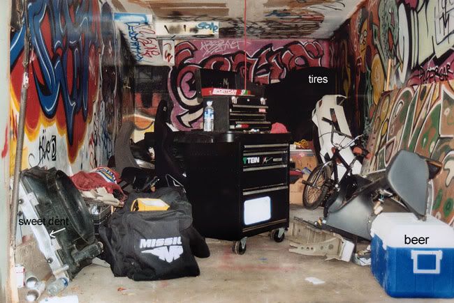

my garage.
