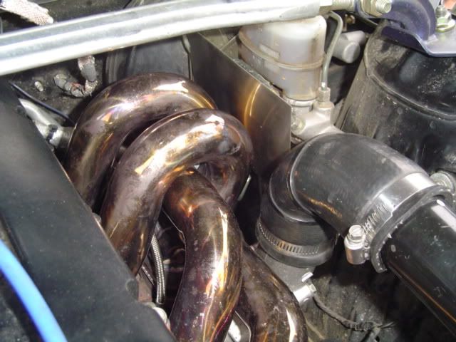

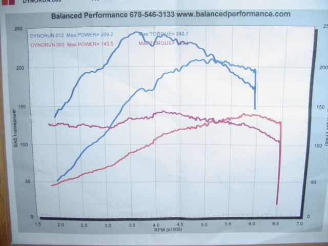

My KA-t is complete, **pictures** (dyno charts)
finally got most of the kinks out of the system and the s14 is back to daily driver duty....
209rwhp
242rwtq at 10psi
here are a few pictures...

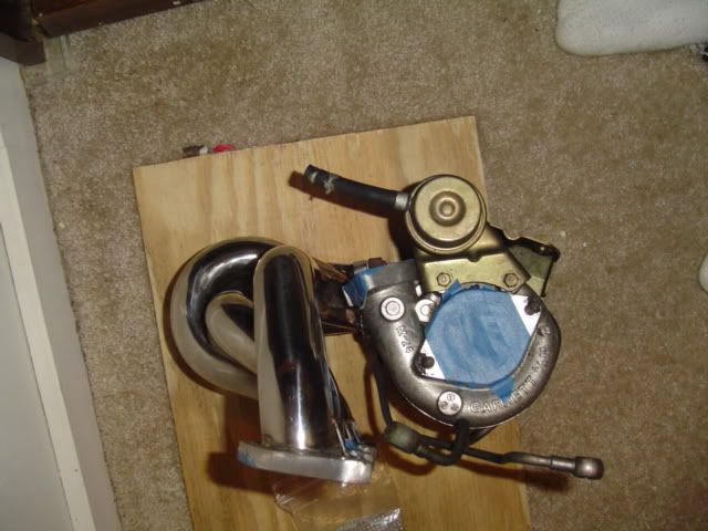

a picture of the manifold before the heat changed it..

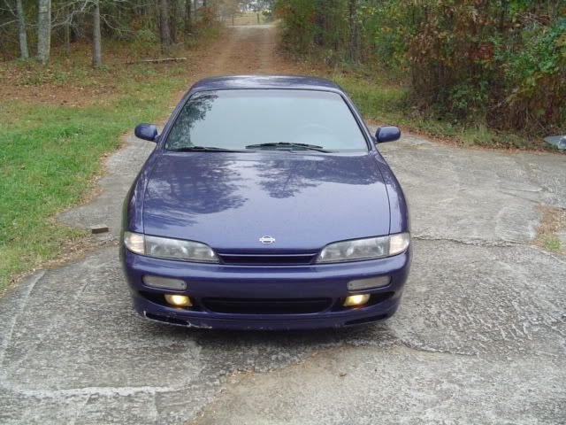

very clean. i like the sleeper approch. keep up the good work!

What size intercooler are you running?

stock S13 SR

Specs would be nice.

very nice at first i thought it was a black top sr20de with turbo kit. very sleeper and stock looking under the hook. congrats.
i 2nd the spec please part.
what injectors ? waht fuel management?

good look...not much chrome piping bs, just the way I want mines...

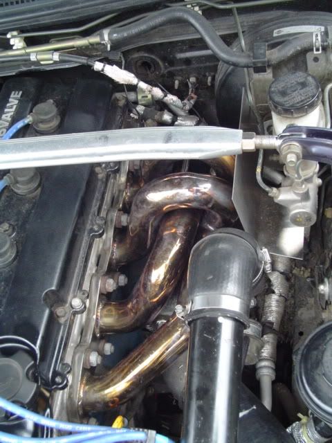

sr t25, sr sidemount with stock piping and bov, 370cc sr injectors, SAFC I, act stage 2, 300zx tt fuel pump and filter, custom 2.75inch turbo back exhaust, xo2 racing manifold, injen intake, stock MAFS, JGS oil lines, custom heat shield, lower heat range plugs, retarded timing, and Balanced Performance Dyno tunning.

looks hella stock..really really nice

i love stock looking swaps, bling gets old after ALWAYS seeing it. agian A+ work. slap a fmic on it for added tastyness. i hope when i do my KA-T sometime next year it will look that clean.

Looks incredible! first time i looked it looked like a blacktop. Very nice, and a nice car to.

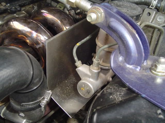

thumbs way the hell up!! really like how you designed that heat shield for MC...looks profecional and way functional.
what downpipe did you use ? was it custom or does somoen offer one that is bolt on deal with that turbo?

damn.. I like that. No officer.. its stock.

Nice job on your install, looks great. I was thinking about doing somthing like that to my S13. Out here in Cali it helps to be stealth.

even like the heat shielding for the brake MC

+1 for stealth/sleeper
nice job on the heat shield

thanks for all the complements guys, I'm not a big fan of crazyness, the goal was to make it fun quick and look like Nissan put it there, but a front mount is on its way. I made that heat shield in my shop with some spare SS I had laying around, works 20 times better than I ever thought it would have.
the exhaust is custom down pipe, high flow cat, and HKS Hiper catback.

sleeper status inside and out. bib prop! I bet the KA now makes the car really fun to drive.
+++ on the MC heat shield.

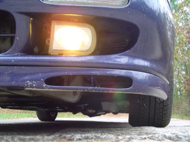

I just like it. Do something about that side mount though!!! I'm not talking about going to a front mount but just to a thicker/larger more efficent sidemount.

Going with a front mount will eliminate that 'stock-ness' you have in the bay. Also, it'll be visible from up front. I think you should keep the set-up the way it is.

is there any upgrade to a sidemount? I kinda wanna know for my plans, but the zenki bumper is giving me problems with how to provide enough flow to anything that's side-mounted

possibly a Z32TT side mount?
FMIC y0!

As for the intercooler, you can run a water intercooler or use water injection. In my opinion, if it run good, reliable and fast, leave it like that.
Or make some ducting to help the intercooler.

yeah more than likely a front mount wouldn't come until next summer when it would be more needed, as for now the side mount is staying, I love it that no one knows my car is turbo charged. As for the final tab, more or less around 800, tunning included. $800-> +70rwhp and +100rwtq ---->I'm happy!
Thanks again for all the complements, I'm glad to see there are more people out there that are for the more sedate sleeper look.
