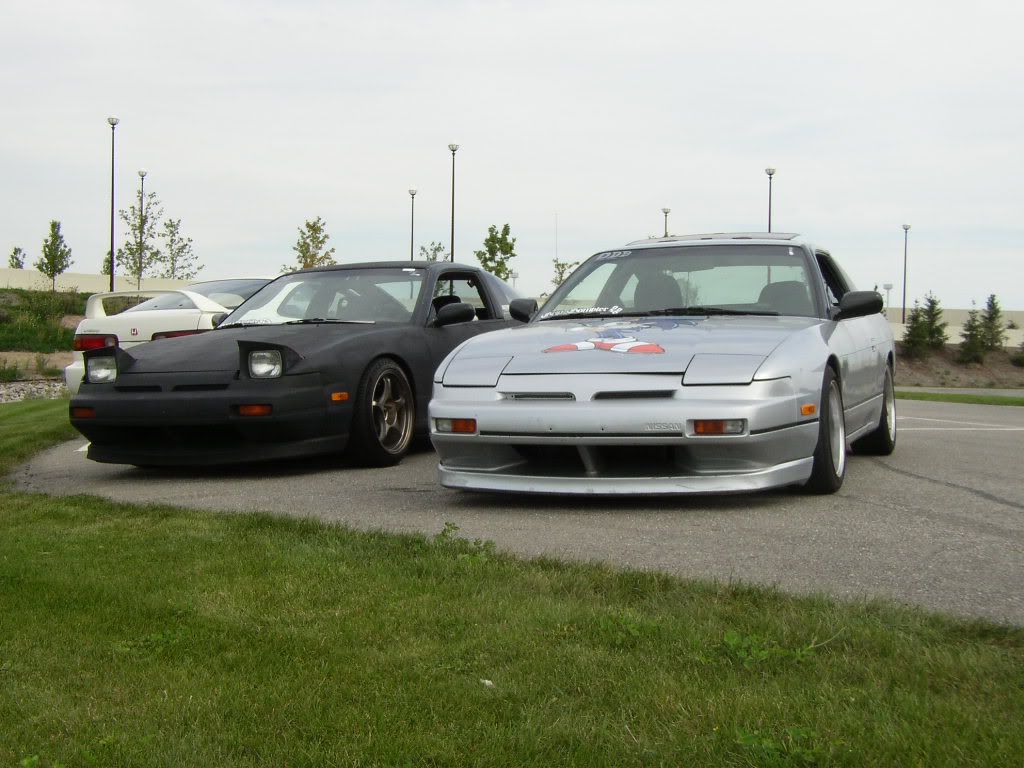

1. S13/S14/S15 = S13 Hatch
2. Suspension Setup = Silk Road RM/A8
3. Wheel/Rim Size front & back = 15x7.5
4. Brand of Wheel/Rim = SSR Reverse Mesh
5. Offset front & back = +7
6. Spacer Size = none used
7. Tire Size front & back = 195/50/15
8. Alignment Specs =
Front: 3.5 degrees camber/0 toe/7 degrees castor
Rear: A lot of camber (prolly 2.5-3)/0 toe
9. Clear Zbrakes & what size brakes = Have stock brakes, won't clear Zs
10. Fender Modifications: rolled/pulled = Rear fenders rolled slightly, but no need unless you run 60 profile tires
11. Picture.. from the side & down the side = Second pic, rear wheels are 16x8+32
4. Brand of Wheel/Rim = Riken Mesh
5. Offset front & back = +2
7. Tire Size front & back = 205/60/15
10. Fender Modifications: rolled/pulled = Rear fenders rolled slightly, but no need unless 60 series tires
11. Picture.. from the side & down the side = Only on front, can't find any pics of them all around
PROCEED
Grip Gambler
KiDyNomiTe is offline   Reply With Quote
