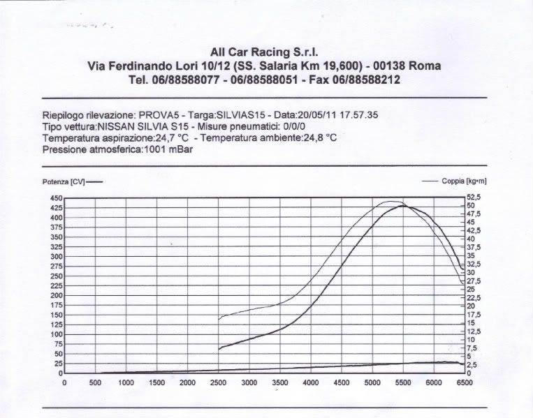

That's the same turbo I have. I made 425whp @ 1.32 bar. I suspect you might make a little more up top with the sacrifice of spool with the 272's. I only have 256's. IMO, get bigger injectors and a power fc if you want this to last.

I was mainly talking about the injectors, 550's are too small for that power level. As for the SAFC, it only controls fuel. What are you gonna do about timing control? I would def look into a Power FC or at least a ROM tune.
IIRC, the Neo can't display knock either.

Send a message via Yahoo to HYPNOTIK
Do you guys understand that on a turbo car the turbo is basically the deciding factor in how much power your gonna make? You can have 5 different setups with different injectors, different ECU's, different brand of cams, etc. and a good tune with the same turbo on all of them and you're gonna get pretty similar results. Just look up a compressor map of the turbo your using and you can guess ballpark power figures.
