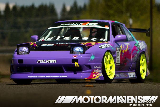

I've got this
and I want more of this
so I'm about to do this
now my question is, will this push the top part of the wheel out more past the fenders? I'm already rubbing as it is. I know a lot of dudes are slotting the top hole on the coilover mount but my wheels are super close to my coil springs already so thats not really an option for me.
I'm wanting to get around -5 degrees without having more poke. Can anyone in here tell me the outcome of a lengthened lower control arm as far as fitment and camber goes?

Let me ask this, are you doing this for pure aesthetics, or for performance? (although I assume aesthetics)

Then why do you want -5* of camber for anything? I could only imagine the actual amount of camber gain under compression...you'll be pushing all over the place.
Lengthening the LCA will get the job done, but obviously be aware now of tie rod length, as well as Tension rod length as well (and how it can introduce a ton of caster, and bind on the inner bushing) as well (causing more suckage)
So again, are you doing this for pure aesthetics, or for performance? The short answer is that it's not gaining any performance edge...

More camber=more contact patch at full lock. I've got room to adjust the tie rods so I'm not worried about that, and I'm extending the arms after where the tension rod mounts so it won't have an effect on that.
Also, front camber doesn't change under compression.

While running more camber enables more camber retention under full lock and compression, you also are now fighting some serious toe in and bump steer when doing it. Lets also not forget that when you're at full luck and your outer wheel is now got (theoretically speaking) 3 or 4* of camber vs the static of 5, your inside wheel (non loaded) is going to be loosing grip due to the massive camber...thus putting (as what I'd say) an undesirable amount of stress on the loaded wheel/tire combo...I just can't see it being helpful for any sort of performance control, regardless grip or drift. There is certainly a balance of static camber to be reached...I just think you're throwing way to much camber at a setup (especially on street tires), when you'd probably have better front grip with 2-3* of static camber.
Front camber does also change under compression, it's all relative to your control arms and how off your roll center is though. I assume at your ride height that they are probably aiming at the moon, so you're obviously going to loose camber under compression, as well as have odd toe movement as well, as regardless of the tension arm being in the same place, it's still a triangulated point and will control how the hub rotates upon compression)
Either way, bust of luck. Not trying to be a hater, just trying to make sense of it all.

slot the coilover lower mount top hole that bolts the knuckle
already stated, but thanks for the input man.
Also, I forgot to mention I'm using s14 control arms too.

it is an option for you because once you run more camber you have to run a spacer to make it flush again so it moves the wheel away from the coilover
trust me i've done it on my car mine is at -7 with a 33mm spacer
also if you have s14 control arms then your camber is already at around 4.5 depending on your ride height
the picture of your car looks like 4-5
the picture you want it to be like is more like -7-8
the top of your wheel will come in towards the wheel well and give you more clearance but like i said you're gonna need spacers
