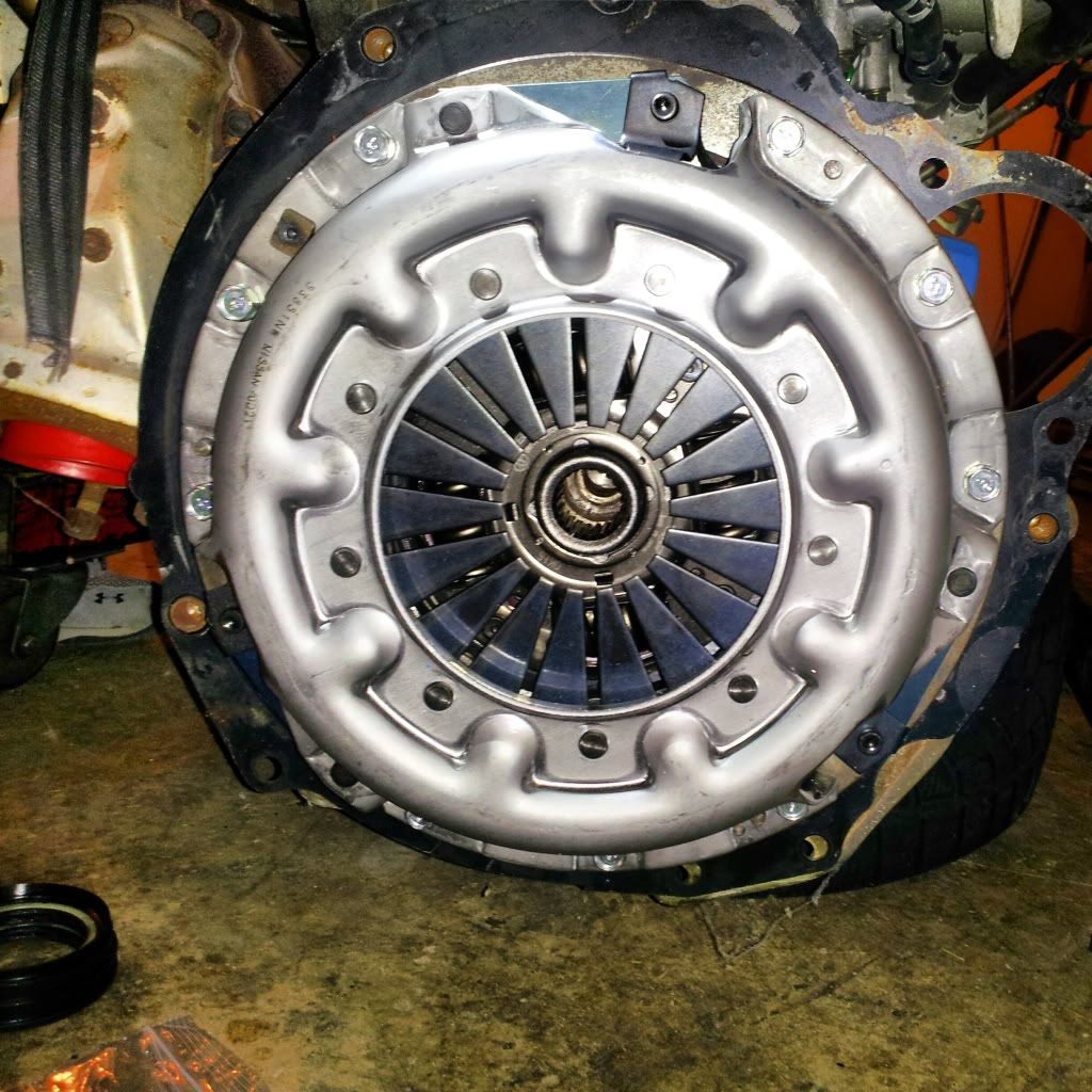

OK. So most of you know Im not a rookie but Im a little stumped on this one. Searched a bit. I google probably 50-100 things a day. Havent found anything useful for RB motors (if it matters).
Ive done probably 4 swaps with this same setup and no similar issues. Ill make this short and to the point.
Problem: rb25 swap. go to first crank. motor locked up. known good motor
Setup:
Stock rb25 s2
RB20 trans
KA white bunny clutch setup
stock driveshaft/diff
Situation:
Motor spun freely before install weeks ago when i replaced the front end (t belt water pump, oil pump). very clean inside.
installed clutch. had a KA flywheel around which is the same flywheel essentially. removed pin on the crank to fit. *didnt spin the motor since front end install*
Rb20 trans spun fine tail and input. lubed up good, went on like butter.
Once I finished the wiring, i roughed everything in. wired the power plugs, start sig, and ground, just to test power and wiring splice. Went to crank and the sound it made was exactly that of a locked up motor. I knew the starter was good because it was the one on my drift car.
Tried.
changing batteries, charging batteries, and jumping batteries. Power is GOOD
changed starter
checked wiring, fuses, battery cables
starting with clutch disengaged (was 5spd swapped prev.- neutral safety jumped)
putting a breaker bar and a 27mm on the crank. no spin
SOMETHING is keeping it from spinning and I THINK its the flywheel. Ive used the white bunny clutch on the 25 multiple times but always used the 25 flywheel because of the pin. This was a last resort thing. I am worried the backspacing it wrong and the flywheel is ON the block keeping it from spinning.
If the motor is know its good and the trans too. clutch seems to be working fine, cant think of anything else. I have read conflicting things about using KA and RB flywheels interchangably and havent found an solid evidence that is does or does not work.
Anyone?

I can tell you right now. You cant use a ka clutch or flywheel on an rb even if it has a rb20 trans. You need to use rb25 or z32 clutch and flywheel.

How can you say you can't when he already said he's done atleast 4 other swaps using the white bunny setup?

Exactly why i toyed around with this idea to begin with. Ka flywheel anyway.
Mind you this is a D21 KA flyhweel. The D21 clutch kit found at any nissan dealer fits exactly perfect on an rb flywheel using an rb20 trans. Ive done it! And is a fantastic budget clutch for a mild rb25 swap.. Those clutches hold awesome on stockish setups. The rb uses a 240mm disk as does the d21.. Ka is 225mm iirc
Whitebunny on rb25

So gathering on this info. I take it that you have done the whitebunny but it was with an rb flywheel and not the ka. Now you are trying it with a ka flywheel and running into a problem? I have no actual info to be helpful on your problem, but trying to clarify things to become more knowledgeable on this for future installs.

Idk. I have compared the two flywheels and they were different sizes. May be the one op used fits, but from what i recall the ka clutch is also smaller or the holes didnt align. This was a while back and i did research which affirmed my findings.
