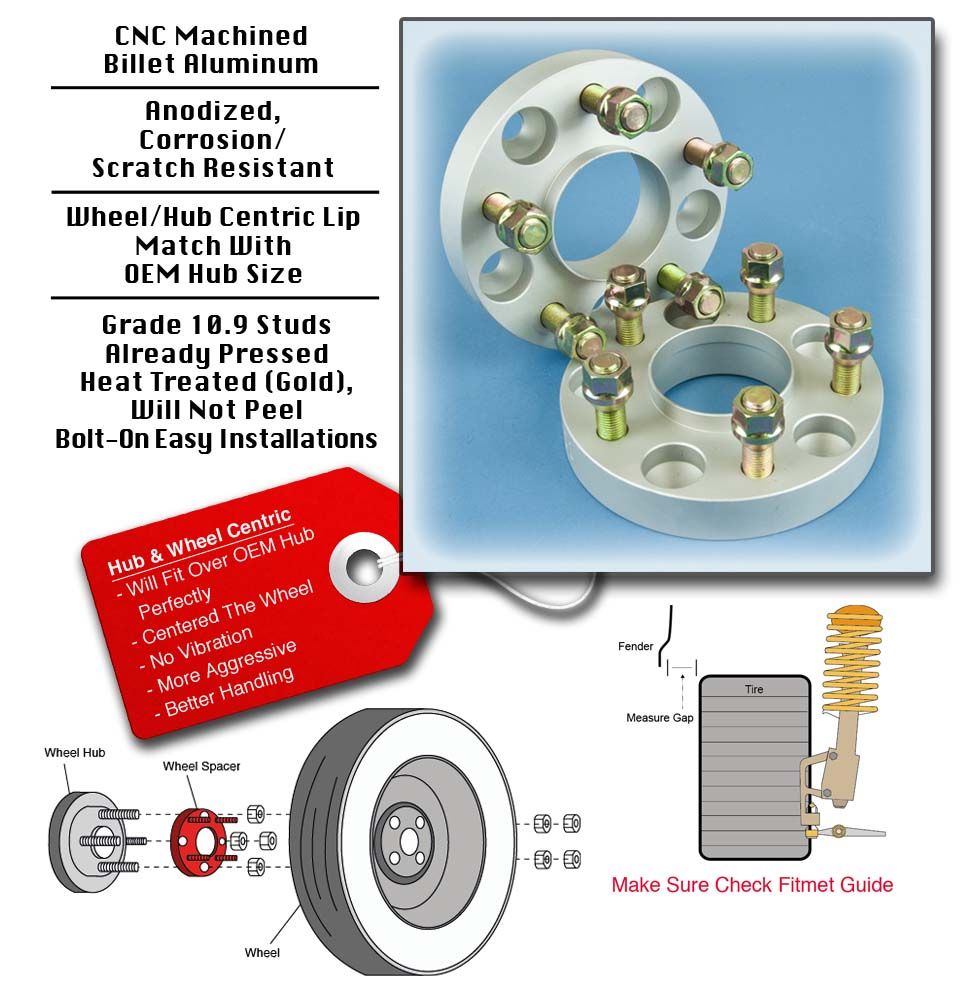

i think it would be safER to just get a half inch wheel spacer rather than stacking (2) 1/4" spacers.
however, you want to ensure that the 1/2" spacer is hubcentric,
also, 1/2" is approximately 12.7mm, might as well just score a 15mm spacer.
something LIKE this Hubcentric Bolt on 15mm Wheel Adapter Spacers Pattern 5x114 3 CB 66 1mm 12x1 25 | eBay
...is the best TYPE, (bolt on hubcentric, rather than slip ons)
