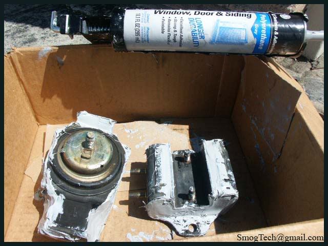

I got these motor mounts for free, I just had to pay $17 for shipping. So, yeah cost me $17.
Anyhow, these were susposed to be done weeks ago, but I keep forgetting the caulk gun.
So, first off, puchase a caulk gun, and 2 bottles of window weld/polyurethane. I went to my local Orchard Supply Hardware, and they were $7.xx+tax. I thought all I needed were one, but meh found out that wasn't enough. Also, get a pair of gloves, and a small box so that you don't get into a big mess.

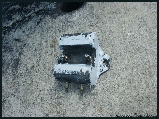

Your clean untouched stock worn out mounts.
Just squeeze it all in, I used a sqaure piece of cardboard to mash it in there, and wipped off the excess to give it a cleaner look.
Tranny mount
I didn't think I was going to take pics, so that's why they're nearly completed. I'll have to wait a few days for them to "cure" then they'll go in my S14.
Total cost to redo 3 mounts about $40(with the purchase of old mounts).
Questions? Comments?

Nice but I think that you used the wrong polyurethane
Its supose to be window weld (black)
Used by glass shops
Anyway, nice writeup
Used by glass shops
Windoweld is black, hondabond (the equivalent) is that color.
I used hondabond on a saturn and had good and not stiff results.
It's less stiff than fully poly and definitely metal, which people do but is insane on a daily driver.

Well.. I wouldn't say it's wrong, but just not the one that most guys use.
If my shifter shakes worse than before..then yeah it's wrong. If it doesn't, then it's right for me.

if you read the bottle it says "Remains Flexible"..but it may work anyways.

How can polyeurethane not be flexible?
3M's site.
http://products3.3m.com/catalog/us/e...er/output_html
Originally Posted by "3m"
Flow grade sealant developed to stop leaks and as a supplementary seal on all gasketless windshield and backlite car models. Flows easily into pinholes and suspected water leaks. Dries fast into flexible, rubbery seal.
I know 3M makes awsome products, this would have been my choice. But it wasn't available from where I bought it from.

aaah you bought the wrong stuff!
that type is TOO SOFT! it wont be rock hard
you need the industrial type that is NOT for windows and such
need the one for concretes and what not
we tried taht and it was WAY TOO SOFT
get the right stuff (brown and yellow tube iiirc) and it is rock hard
thats what we (myself and maeda) used!!
that stuff you got WONT BE SOLID
mines like solid

I used some Urethane caulking from the local hardware store on my car, and a friends car (both 4G civic's). Almost totally eliminated wheel hop
It doesn't matter that it won't get entirely hard, it fills the voids and stiffens it alot anyway. On my brothers car (AWD Talon) we filled the mounts with silicone because he daily drove the car. It is much softer, but still helps to eliminate engine movement, without as much vibration.
I think choice of a fill material is upto the person doing it. You can get harder or softer depending on your goals and use of the car.

Ah. Sorry to tell you this smog tech but I bought that stuff first and tried it on a piece of plexi...
It turns into something very similar to caulking.... (go press the seals in your shower to see how 'stiff' this stuff gets)
This is the stuff dousan pointed out to me when giving me a ride to homedepot.
