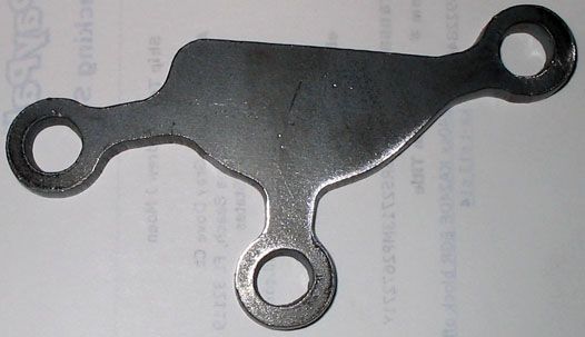

Nissan Part # for EGR block off plate? ka24de

the blockoff 'plate' is not a nissan item. i know hotlinking to ebay is not allowed here, but please take note this is NOT mine or a friends product, only to help the original poster.
http://cgi.ebay.com/240sx-KA24DE-EGR...QQcmdZViewItem
^ that is what most people use including myself on my last 2 ka-t's. works like a charm, just get a new nissan gasket or silicone.

just make a block off plate with two holes in it. Then bolt your stock egr pipe over it. Just in case you decide to go back. Easy peasy.

An EGR block off plate means you fail smog..
Bending and welding the tube will look ugly as fuck as Johny5 said 'cuz you'll have a chunk of tube hangin' around in your engine bay.
My friend made me a plate in 20 minutes out of steel and I just gasketed and RTV'd it..
Less than $15...

I got the eBay plate and it fits great.

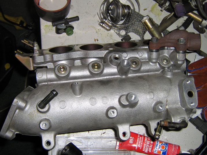

does the block off plate sit in between the EGR and the throttle body or does it replace the EGR altogether? Anyone know where I can one for a KA24E?

goes in between the Manifold and the EGR adapter.
Installed:

Originally Posted by murphy
s14db whyd you put the adpater back on?
Stock bolts are to long for just the plate and I'm to lazy to get washers or shorter bolts.

ahha ok cool. but you dont need the adpatar if you just use the plate and shorter screws? is it possible to do this with the IM in the car?
and what you use to shut the pipe hole on the exhaust mani? also what for the aiv valve

You can use the AIV plug or get a nickle and use the stock pipes threaded adapter.
