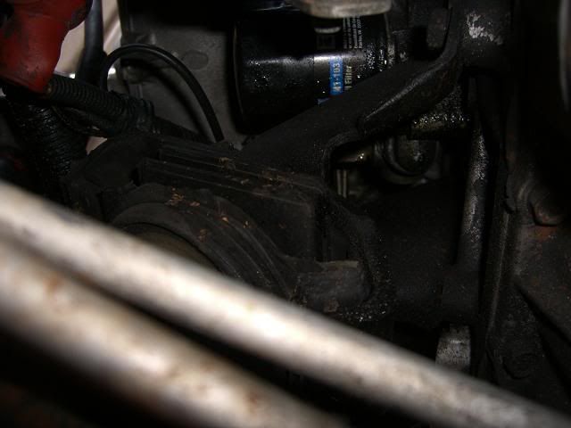

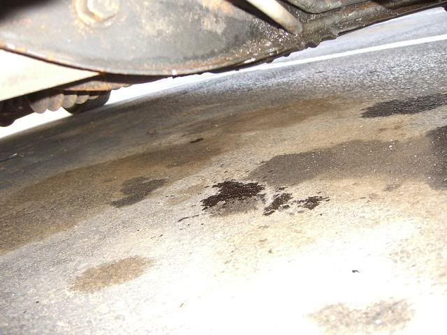

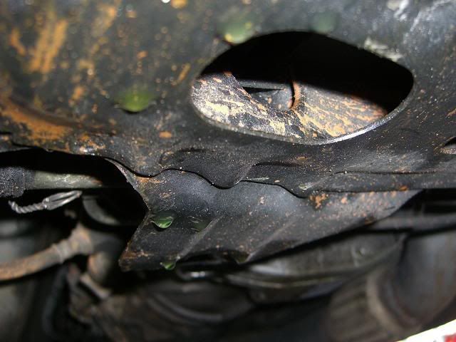

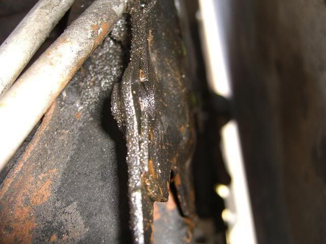

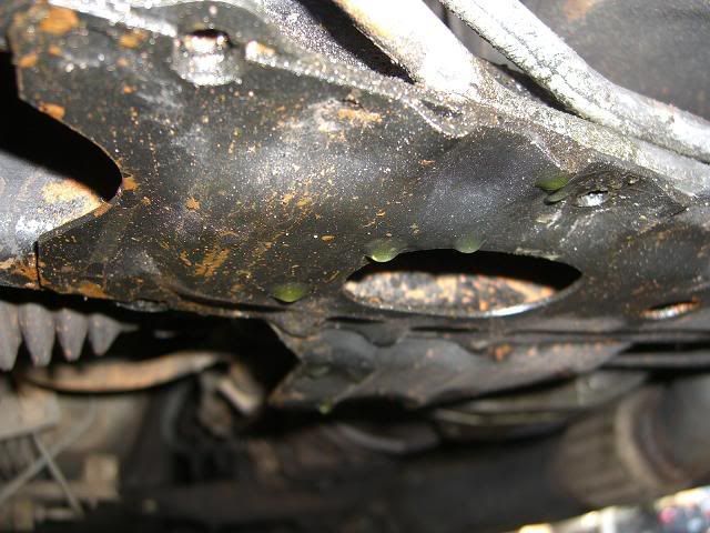

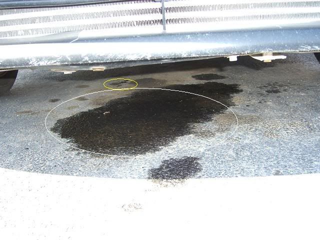

i managed to snap some pics of the leak.. since i put on the flash i finally got a chance to see that the liquid was green (coolant?).. never once did it over heat.. i have a huge koyo alum radiator with twin fans.. (but the temp gauge in the car did keep jumping from normal operating temp to cold..).. all i've owned previously were honda/acuras so this all this is sort of aliean to me.. anyway here are the pics.. i was trying to also make a video of the sounds it was making but i needed a jump and no one was around..
here in the pic i backed out a little so the white circle was before i backed up (and its been sitting there since monday) and the yellow circle was when i just backed it out.. so as you can tell it's leaking pretty bad.. but no leaks where the tranny meets the block..
could the leak be the major cause of why my car isn't catching gear?

That's just coolant, could be from anywhere judging by the location but that's not the culprit.
