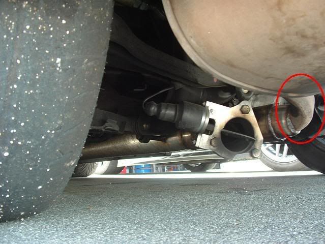

I run the same setup on my built ka-t but the QTP one.
Just make sure you put it has close to the muffle as you can.
On the dyno at 5.6 psi I did 205rwhp with the cutout closed and 241rwhp with it open.. With a gutted cat...
Cops dont even look twice at me..

I like that book as a starting point, because it cover the absolute basics. Sections pertaining to wavelength and design are among the best practical explanations I have found. There are better more updated books, with the info presented in more of a practical manner, but they work off a foundation of known truths that I don't think all people may be in touch with.
240whp. Well GTFO out of here. Man that is so much power. and from 205 to 240! I wonder where the restriction was?
Oh right there, the horrid multisize crush bend.
Originally Posted by JohnGriff
This is worthless. You WILL lose power vs the stock exhaust, unless it is clogged, in which case something would be broken, and should be repaired.
You also have the cutout after the axle. You are retaining the legnth of the piping which is a necessary component to scavenge.
Now to get down into the mud. Honda Crews since 2003? With 240hp. You've got to be kidding me. I have met a couple of you guys, and you were all really nice, which is why you strike me as something else....
Is this you? http://www.youtube.com/watch?v=pB76eJDp3Js
Getting stomped on by a honda on manville? Ricky Racer street racing bs doesnt go very far. I was doing that in the 90's while you were still in middle school.
Get a full 3 inch cat back, it will serve you allot better.
Why length is important. While the volume argument might make sense, and evacuating exhaust sooner might seem like a gain, it is not. Enough cannot be said for a properly tuned pipe. Exhaust travels through a pipe in a wave length fashion. In that wave there are high frequency points, and low frequency points. These are pockets of high pressure and low pressure.
These pockets of low pressure act as a vacuum to the high pressure wave, accelerating their exit from the exhaust. If the pipe you use is too short, the exhaust will not build enough velocity on exit to maintain this effect. Too long and it will loose energy and create a dead zone or back pressure. There is a balance to this effect as well, when dealing with the CFM of exhaust output vs the diameter of piping.
From the drawing board, engines are optimized using cam/valve timing for a specific length of exhaust. The easiest way to work around modifying the length of the pipe is to adjust the cam timing. The added benefit of utilizing a full length exhaust in a turbo application is transient response of the turbine and rate to full speed of the turbine. The vacuum/scavenge effect will keep the turbine at a higher rate because the exhaust flow in the pipe is literally pulling the exhaust past the exhaust wheel.
In a naturally aspirated application, the length is playing the same role, but fullfilling what could be a much more necessary need, exhaust/intake stroke overlap. The point at which the intake and exhaust valve are open is overlap. At this point in the cycle the temp/pressure of the used fuel/exhaust gas pull out of the chamber, while fresh intake/fuel air mix is sucked in. The scavenge effect greatly increases this effect by pulling the exhaust out of the chamber, and at times sucking through intake/fuel mix. Besides completly cleaning the chamber of excess exhaust, the cool intake/fuel mix enters the exhaust port in the overlap, cooling the exhaust valve, header and system. This leads to a lower likely hood of detonation in an N/A application because of a red hot exhaust valve.
Hopefully I broke it down for you hommie.
with a specific camshaft, head design, compression ratio and tune, yes.
But...with an EMS, high lift cams, and dyno time, you can tune for any length and style system your heart desire (maybe some machine work too).
I used a cut-out for drag apps back in the day. I had it half way down the exaust. It definitely had a negative effect on torqueand low end power but the higher ranges of the motor where exaust gas and movement of air was faster there was less effect and one a dyno more power.
There are plenty of people using t-cut outs on their cars for street racing or drag cars but if your doing a response oriented setup with anything other than a built head and ems, stick to a full length exaust with a muffler to meet your sound needs. It will be mroe beneficial for spool time scavenging etc.
The crush bend is factory, that’s why I put the cutout right before it.. You said the cutout is worthless in your first post that’s the only reason I posted.. The cutout is the best thing you can buy period..
Like I said that was only at 5.6psi… wtf do you think I do at 20psi+??
Yes, that is me.. that Honda has 503whp, if you look at the other video that is linked from that video you can see clearly that I spinning/getting sideways instill top off 3rd.. so wtf is your point? If you want to do it from a line PM me simple..
