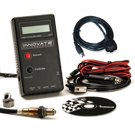

Like John said your gonna overheat the sensor which will cause false readings. Innovate recommends on Turbocharged motors that the wideband be placed 36 inches after the turbo.
This isn't really for permanent installation, dont forget Wideband O2 sensors DO NOT LIKE being rich all the time, if you run like a 12:1 AFR you'll destroy your sensor in a few months, and leaving it in and not turned on will destroy it even sooner.
But if you truly want the JAW kit can output a narrowband signal which you can feed directly to the stock ecu.
As for part number
VW Part#021906262B
Bosch# 17014
More info on the harness parts
http://14point7.com/JAW/JAW_FYI.htm
I tried to mimick the functionality of the Innovate LM-1 the only difference is mine is just smaller.
