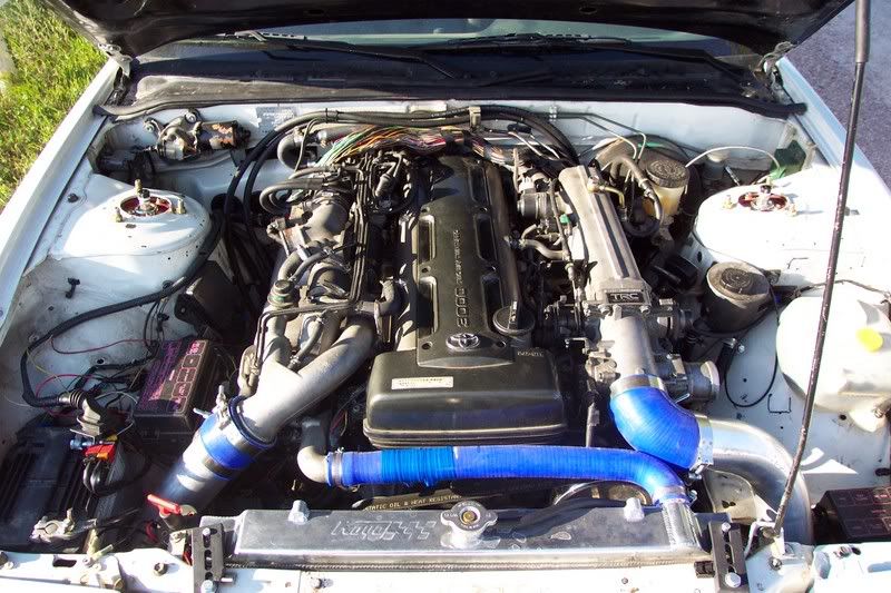

Motor is easy to drop in from above.
Mount details coming soon.
Tyler
did you take the front rad support off to do it? i found that on the s13 you really have to get that motor tilted pretty far to get it to go in smoothly. I also had clearance issues with the firewall in some spots (to get the motor to mount to the subframe)
driftking777 is offline   Reply With Quote
Nope, just like a normal swap.
Tyler
HellonFire is offline   Reply With Quote
Tyler
what kind of mani/turbo is that??
it looks like the MTR mani
