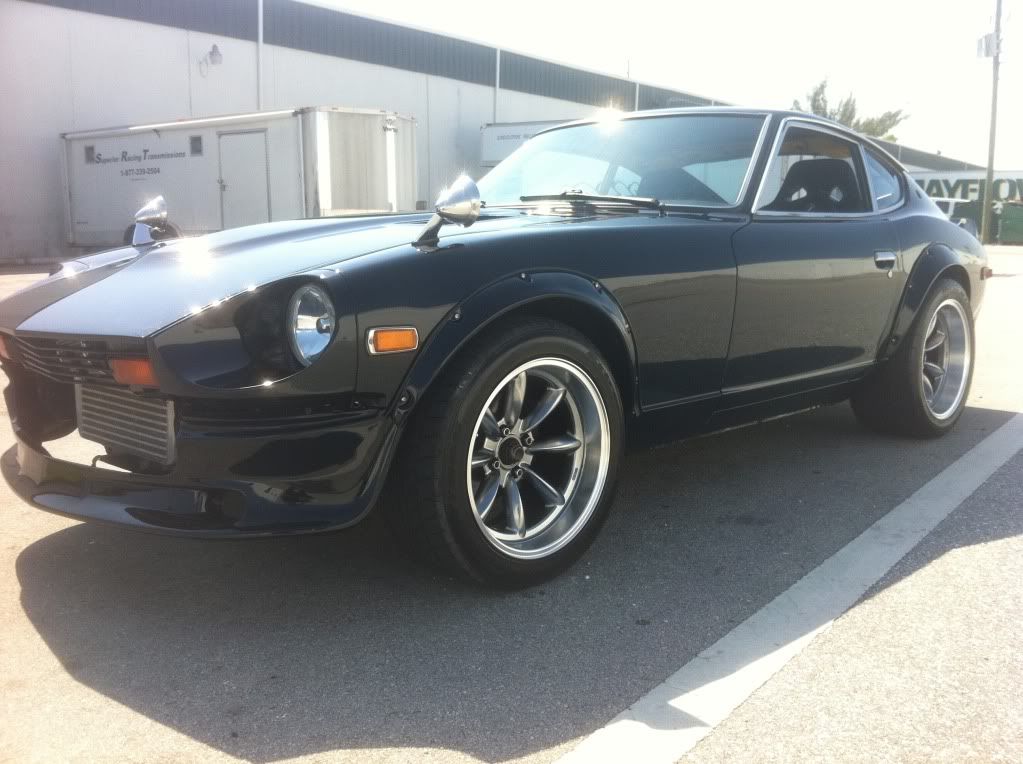

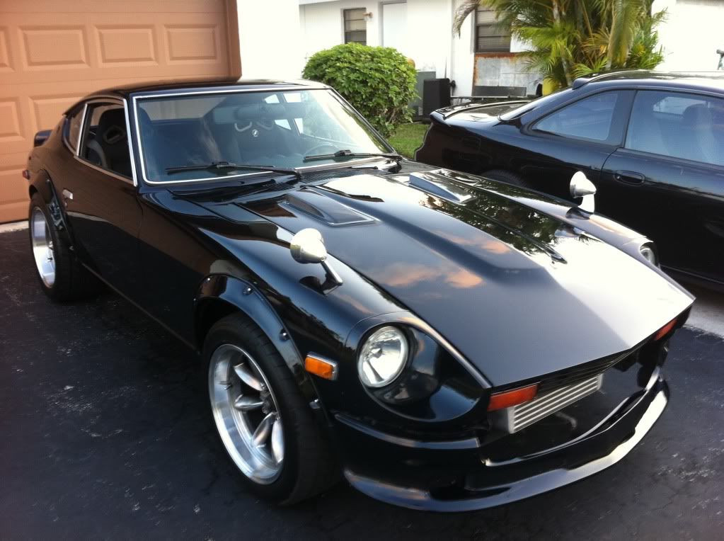

Z U L8R's 280z RB25DET *Mod list* / goodbye tribute
Sold the car to a close friend of mine. Here is the list of the mods it had, in case someone has similar goals in mind or u were just curious to wtf i had done to it.
I believe i was lifting the head cause hadn't yet retorqued the arp head studs, hence the dip around 5200rpm, but mainly Turbo Dave tuned me for 20psi on 93 octane (pump gas) and i put 100 octane in it, cranked it to 22psi then strapped it to the dyno for the 441 run to see what the air fuels were at 22psi, i wasn't tuned for 100octane nor 22 psi, here's a cleaner graph from an actual tune and not a dyno queen peak power graph after i swapped the rear end from a 3.9 to a 3.54
pink was 20psi pump gas with the 3.9 rear end old tune
red was 14psi "low boost" with the 3.54 rear end new tune
blue was 20psi pump gas with the 3.54 rear end new tune
you can see low boost holds the torque true all the way to redline
but 20psi at 6k rpm the turbo runs out of steam. .63 a/r is the smallest version of the gt30/76r , if i went to the .8X or the 1.X (bigger housing) it'd be a little laggier but it would support it all the way to redline. overall the 30r is a kick ass turbo if you want 400 or a little more.
*SUSPENSION*
energy suspension complete bushing kit
toyota 4x4 4 piston front calipers
*RIMS*
Riken 14x7's with bfg t/a 245/60/14's in the rear fronts are 215's
*INTERNALS*
Commetic Metal HG
ARP Head Studs
(that's it for these dyno's, first motor lasted 7 months, timing belt idler pulley locked up, shredded timing belt = bent 19 valves, dropped new motor in /w hg & studs, lasted a month, was at the drag strip and drove it home with uber blow by.the plastic vacuum T to the fpr/profec cracked so it under fueled & over-boosted aka leaned out the motor and fried the piston/rings. after that i did wiseco 8.5:1 pistons +acl bearings + new oe oil pump, lasted a couple months then threw a rod on the dyno cause the stock rod bolt snapped...worst thing was i paid for pistons,rods,bearings, & machine work, and got everything but the rods, but i put it back together instead of bitched about it so...that's on me)

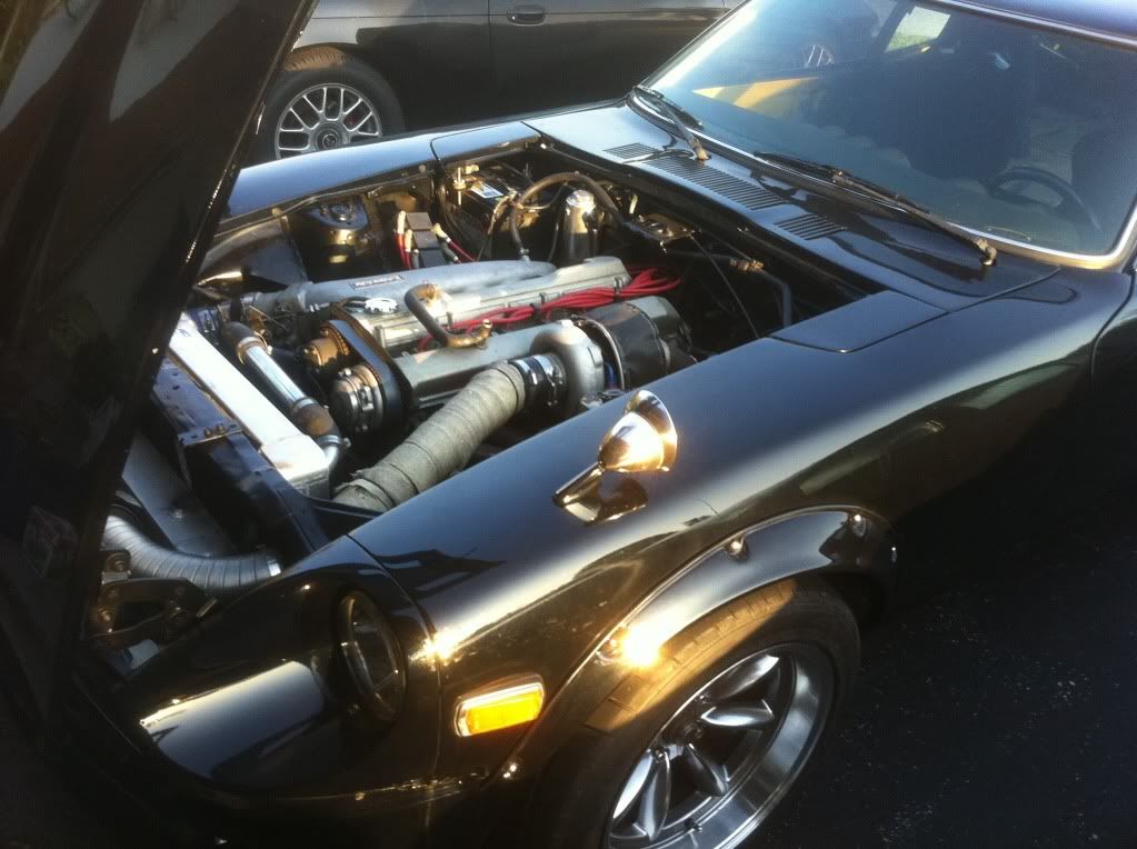

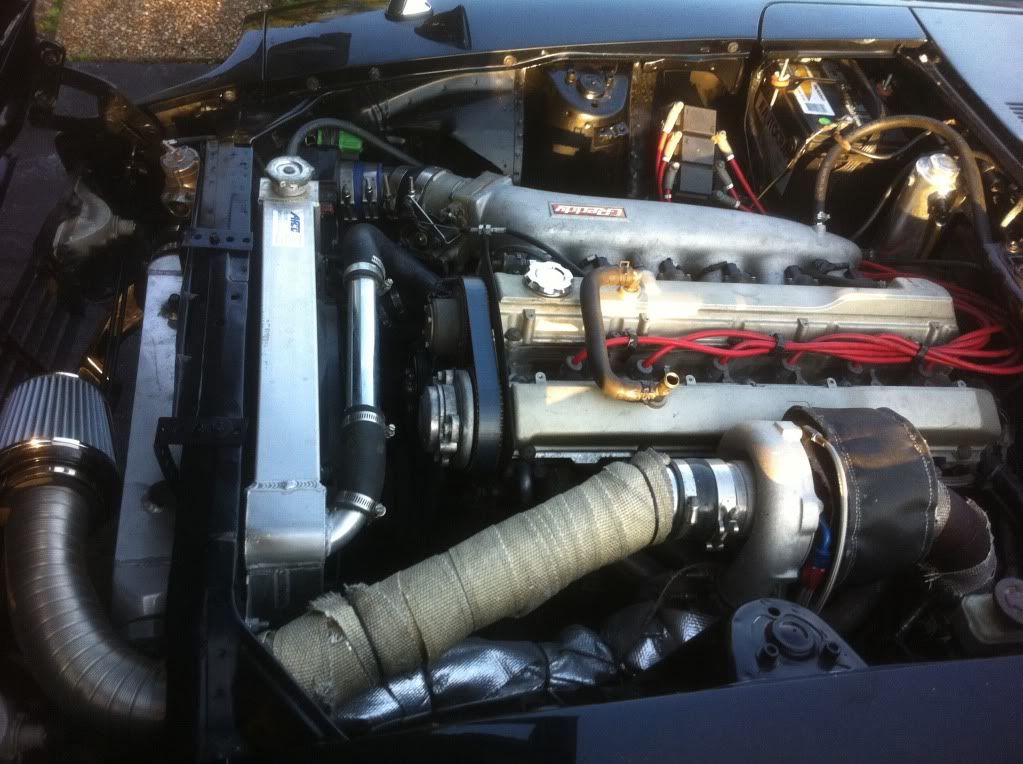

*MODS*
GReddy intake manifold
GReddy timing belt
GReddy Profec
Walboro 255lph inline fuel pump
Q45 Throttle body
Z32 MAF (blow through)
Z32 n/a 5 speed transmission
OS Geiken Super Single 6 puck unsprung clutch & flywheel combo
Ebay bar & plate fmic 25" x 11.5" x 3" core (27.5" from tip to tip)
Apexi Power FC
DeutcheWerk 550cc side fed injectors
Precision GT30/76R .63 a/r hot side, .60 a/r compressor side
XS Power top mount exhaust manifold (had to angle the turbo flange away from the valve cover a little so the compressor housing could clear it)
Tial 38mm external wastegate (9-13lb spring)
AFCO aluminum racing radiator
N1 water pump
Gizmo phenolic intake manifold gasket
BCPR7ES @ .028 or BKR7E @ .028 gap
Buick Grand National Ignition coil pack
MSD 8.5mm Wires (if u buy the v8 kit they're longer than the v6 kit)
Blitz Bov
Magnaflow 3" muffler
*THE MEN BEHIND THE SCENES AND SPECIAL THANKS TO*
Wouldn't have done it without these guys
motor mounts by Joey Dacus @ Landrum Manufacturing
Intercooler pipe,exhaust, transmission mount & other various fabrications done by Turbo Dave @ TDF fabrication/mainstream
Tuned by Turbo Dave
Basically I'm not the best welder/fabricator so i had those fine fellas handle that for me. Everything else I did myself. My specialties are engine diagnostics and Wiring.
thanks also to all the guys at Mainstream Performance, Top Hat Performance, Lethal Injection and everyone else for their help and support.

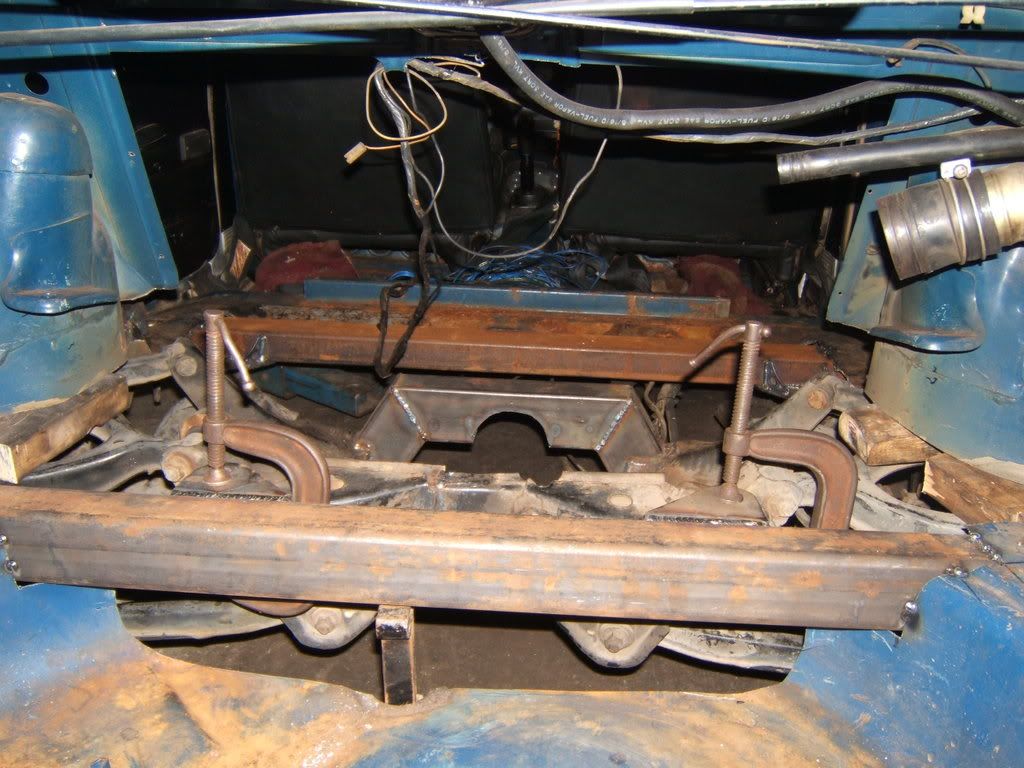

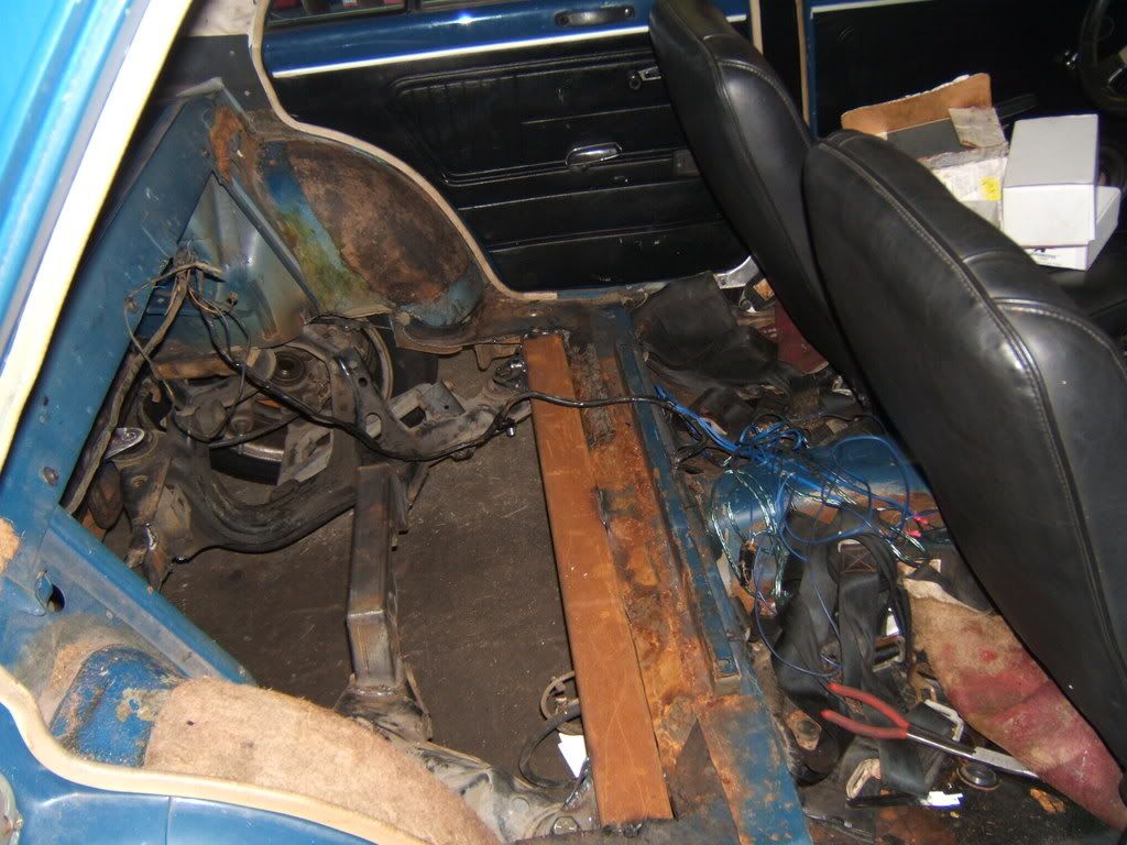

UPDATE ON THE 510
got the whole s13 rear subframe in the 510 with a 2" mini tub + z32 TT 3.6 r260 vlsd. the rear seats have been modified to fit back in place like nothing happened =]
that inline walboro 255 is going in the trash
ground control coil overs on the front with toyota 4 piston calipers
16 gallon fuel cell with sending unit + aeromotive eliminator fuel pump
z32 5 speed tranny /w custom front bellhousing to bolt up to the KA (projectrsdm, thanks for the z32 tranny, he's a great seller by the way LOL)
gsxr1000 individual throttle bodies (custom KA plenum in progress)
i have a polished b210 brake booster and currently using a 280zx brake master cylinder with a summit proportioning valve.
i had wilwood 4 pot rear calipers on the 510's rear but now i can upgrade the s13 rear to 5 lug and bigger breaks + s13 coil overs and all the fancy shmancy adjustable suspension crap.
the rust looks worse than it is, but here's the diff mount in progress =]
this is before the inner rear fender wells were moved for the mini tub

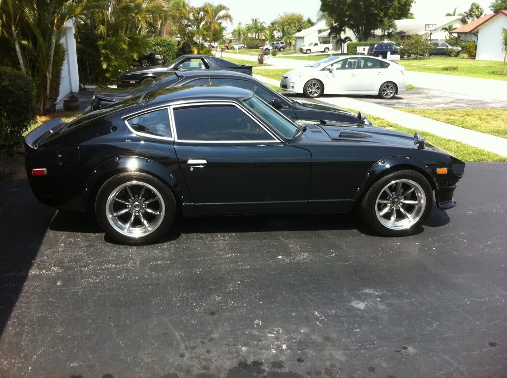

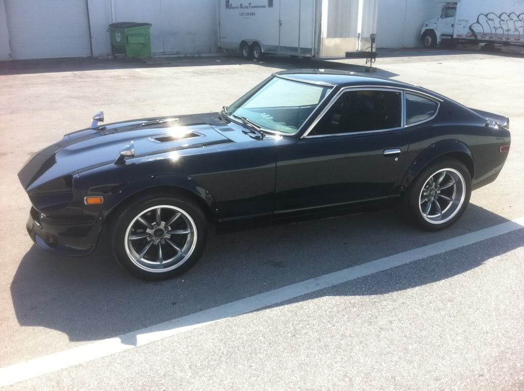

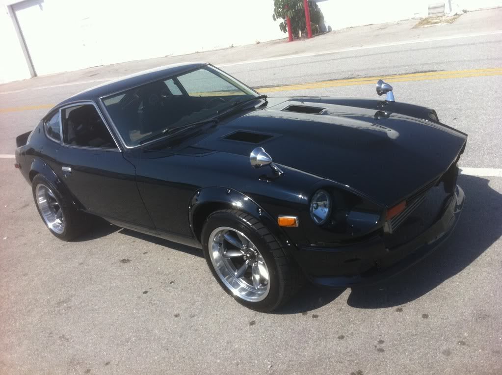

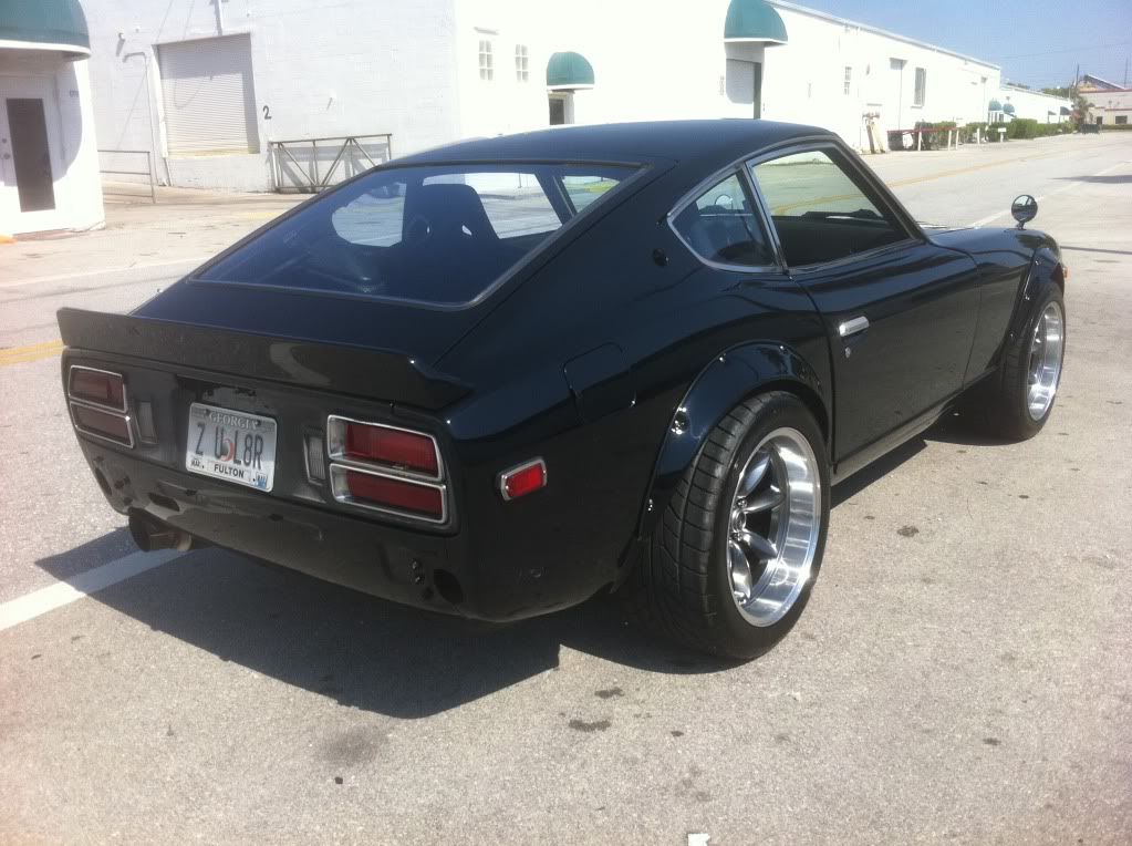

Muwhahaha I GOT MY Z BACK!!!!
MY FAVORITE PIC
I like the Carbon Fiber hood scoops ^_^ , now i just need to get her in a magazine
NEW MODS:
No more rust!!
New floor pans and frame rails
All new weather stripping
New rims/tires, 245 on the front 275 nitto's on the back. Rims are Rota's
Jdm mirrors
Bre rear wing
Corbeau racing seats
Over fenders
Brand new black with blue pearl paint job
Arizona Z car rear mustache bar
Motorsport auto full coil overs
CF hood scoops
CF steering wheel
Nismo shift knob
6k HID's
Defi Heads up display Tach/Speedo
Engine Mods:
JE 8.5:1 forged pistons
SPOOL rods
ACL race bearings
Commetic Metal HG
ARP head studs
Custom Clutch Specialty 500+hp 6 puck sprung pressure plate, unsprung disc
The rest is the same as before, motor has ~7,000 miles on it.
She is for sale, serious buyer only please private message me
God is good!!!
Dave
RB25 280z GT30/76R 441hp/381tq 11.9@125
Z U L8R is offline   Reply With Quote
Old 05-22-2011, 08:40 PM   #25
Neejay
Neejay's Avatar
Location: lol
Posts: 2,586
Neejay is close to perfectionNeejay is close to perfectionNeejay is close to perfectionNeejay is close to perfectionNeejay is close to perfectionNeejay is close to perfectionNeejay is close to perfectionNeejay is close to perfectionNeejay is close to perfectionNeejay is close to perfectionNeejay is close to perfection
wtf man. haha
I was about to ask if you moved back to ATL, until I saw the palm trees in the last few pics. lol
I sold my RB25 s13 too...I think I'm out of the 240 game.
Neejay is offline   Reply With Quote
