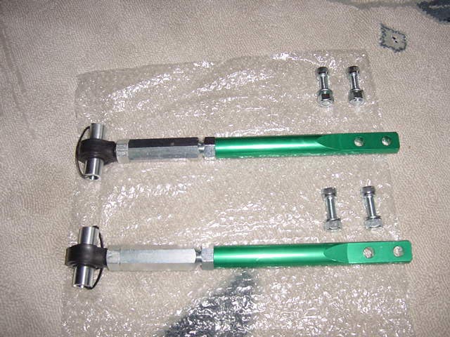

ok I got my new t/c rods from pdm or i will have them this week just wondering if when removing them the weight should be off the wheel or what?..i guess the wheel wont go flyin or anything when i remove the bolts.?

Probably the easiest way:
1-jack up the car a foot or so jus to get some room to work
2-loosen all nuts
3-slowly lower the car an inch at a time and see if the rod has loosened.
if you don't get the right lift height you'll have to fight it on removal and installation.
BTW: have a 5 lb hammer ready....worst case you'll be running over to nissan buying more bolts and nuts because you had to cut thru the bolts.

Although I haven't changed/replaced my T/C rods, I would have to recommend working with the wheels off... You will definitely find it easier to work with that much more room!
I take it you got T/C rods with whiteline bushings pre-pressed? Let us know how they feel, I'm going to be in the market for t/c rods after Xmas. <img src="http://www.zilvia.net/f/iB_html/non-cgi/emoticons/thumbs-up.gif" border="0" valign="absmiddle" alt=':thumbsup:'>

Mine took 4 hours - thanks to a parts run for a new socket (I broke three chrome sockets):
Tools:
Jack and stands
one soft, black, impact socket for the nuts
one GIANT breaker bar
a gallon or so of liquid wrench (okay - maybe a can will do)
Process:
I jacked up the car and put it on stands
Took off the wheels
Loosened the bolts (this was a bitch&#33<img src="http://www.zilvia.net/f/iB_html/non-cgi/emoticons/wink.gif" border="0" valign="absmiddle" alt=''>
Took off the old
Installed the new
Really, it is just a bolt up job - nothing tricky. &nbsp;The only thing is that it is a bitch to get the old ones off.

agreed with Hipposleek if you got new ones (i got adjustable Monkey Magic nits with Pillowballs, no more sloppy bushings ever for me &nbsp;<img src="http://www.zilvia.net/f/iB_html/non-cgi/emoticons/thumbs-up.gif" border="0" valign="absmiddle" alt=':thumbsup:'> ) its an in and out job take the wheels off. &nbsp;it'll be much easier.

Take them off however is easiest. When I re-intsalled, I left the bolts on the control arm end "hand tight" and then tightened it up the rest of the way with the weight of the car on it. I don't know that you really need to but I'm one of those dorks that follows directions.
