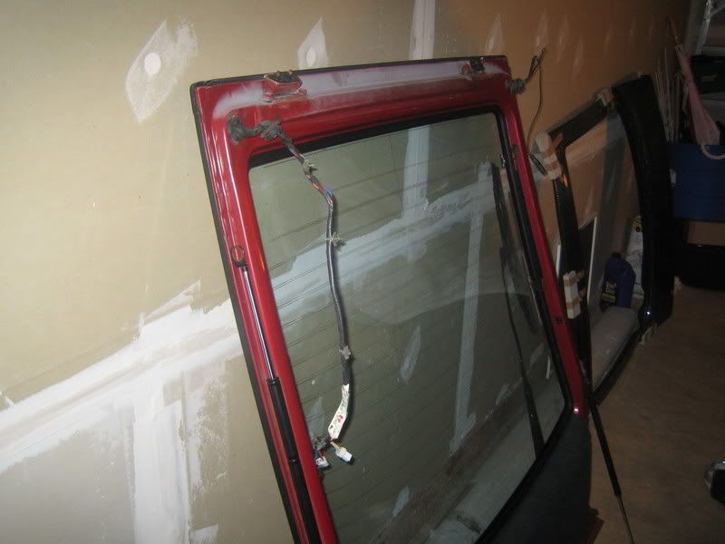

Car should be painted with new aero soon so shouldnt look like yours for too long.
No integrity issues at all. Yeah i used the stock hinges to mount the hatch. To get to the hinges just pull back the headliner closest to the hatch (opposite from the headliner towards the front window) Theres just a panel holding it up after that you should be able to pull it back.
I inplugged the harness rather then splicing them.
Here is the hatch off:
Hatch back on!
FYI!!!!! When i got the back window removed I had to get new molding (existing molding cannot be used again) I had to buy new molding from the dealer. The price was......ready for this......200 dollars. A lot but it got the job done. Just something to think about.
