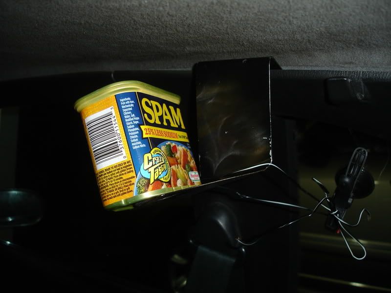

this is what i have so far...mounted on the pillar bar.
i put a junk digi to show you better.
i still need to go to home depot to get suction cups for an external mount.

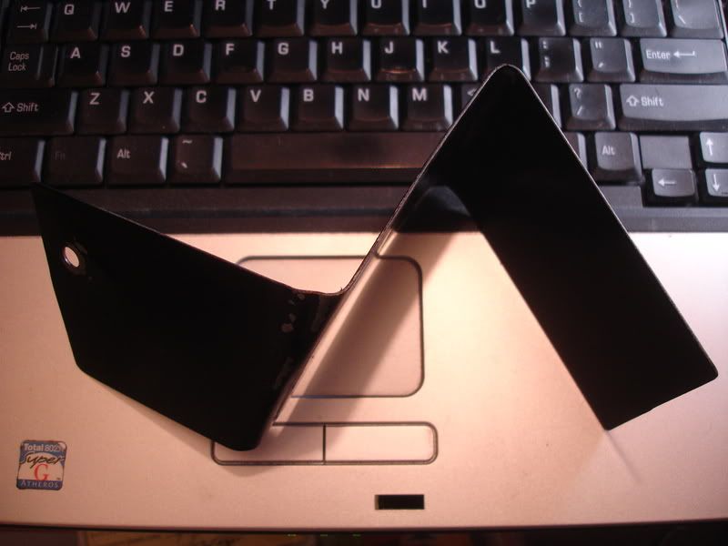

this ones the inside mount
about 10in flat sheet bent in three ways. some of the bends are a little angled. you gotta find that out yourselves to get the perfect angle for the camera. have about 4-5 inches before the bend. and then a hole in the other end for the camera to screw on
then the 4-5 in. that i was talking about slides into the rear window panel. i used some suction clips and wire to kinda make a leg so that it wont vibrate.
and there you go!

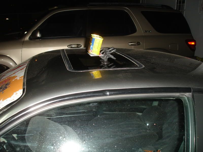

next is the outside one.

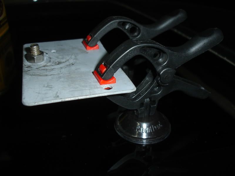

flat metal piece again. drill a hole for the camera screw.(dont mind the other holes. it came with the sheet)

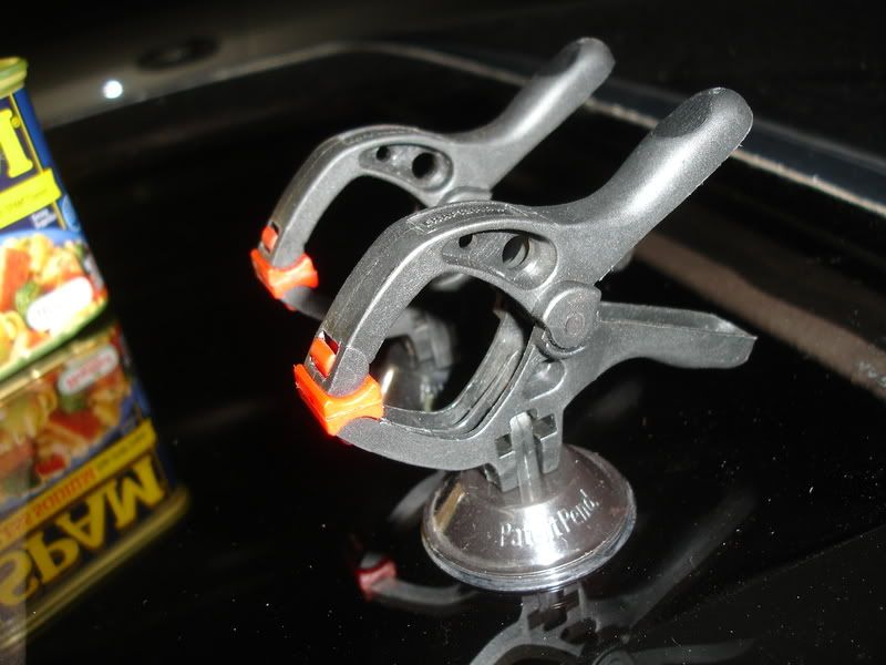

some suction clips. idk what theyre really called
and bam! roof mount
you might wanna add some extra security and tie the sheet to the clips or something. just incase theyre not gripping hard enough

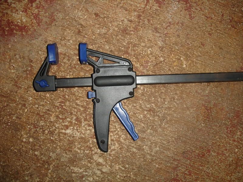

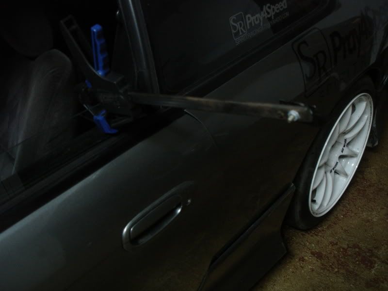

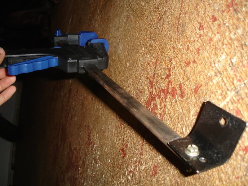

then the side mount
idk what kinda clamp it is but its in home depot

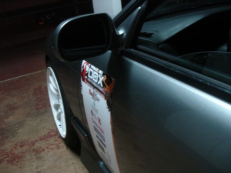

made a little right angle with a small sheet to work as a mount.
and clamp it to the window. my mount was on backwards
