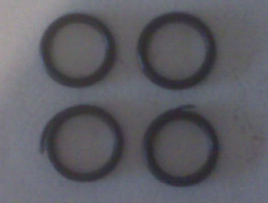

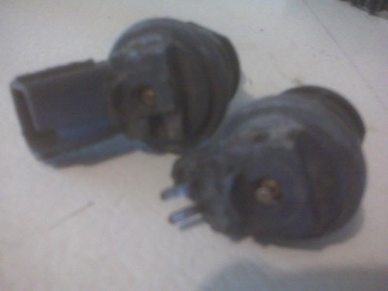

Todays Update:
So I pulled the injectors yesterday and took a look at the O-rings. Two of them were garbage as you can see (bottom two)
and i also notiuced one of the brass buttons on one of the injectors was missing so I picked another one up this morning and put all new O-rings on all of them. Heres a pic of the injector with missing brass button (left) next to the good one (right)
I also put in new spark plugs: the others were toast and seemed like they haven't been changed in awhile.. Also messed with the MAF wiring and that didn't do anything..
i think it's pretty obvious I need a tune.. I've already decided I'm gonna get an ECU tune of some sort. I know some one selling an enthalpy for pretty cheap thats already tuned to my setup. Well i talked to the seller on the phone and it was tuned for a t3t4 turbo with 370 injectors and n60 maf, but he says it will work for my t25 with 370s and n60 maf. Is this accurate? I've heard the enthalpy tunes are pretty good ones and the price is decent. Let me know, any feedback is appreciated

It's a good thing you pulled those injectors to replace the o rings, the car will never run right if you have inj fuel leaks.
