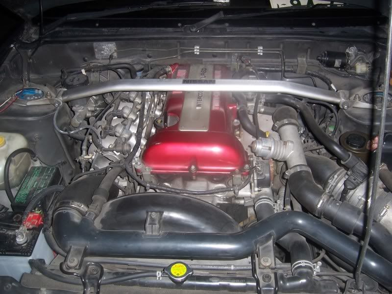

Here ya go, Im kinda embarrassed so show this vid, ..... but at 2:30 is when i will show the gauge
Quality is crappy due to it being dark but its better than nothing
But FYI stock boost is .7Bar
YouTube - 180SX 2.MOV
Edit: Heres the Engine bay of the same car.

You must have missed the video that I posted,
The Video is a J-Spec 180SX BONE STOCK only BOV and Intake filter are installed.
As you can see on the Greddy Gauge its shows .7ish Stock boost = 10ish PSI
If the system is hooked up wrong then the turbo would over boost seeing around 18-20psi... so no the STOCK system is not hooked up wrong.
You would probably see .4 -.5 Bar if the boost solenoid was bypassed and a Vac line was connected directly to the W/G.
S14 might be lower since they run the same injectors with a larger turbo.... but you'll have to show me some evidence.

I had a fully stock Silvia S13 (redtop, stock t25, everything in place...) and stock boost was 11psi...
