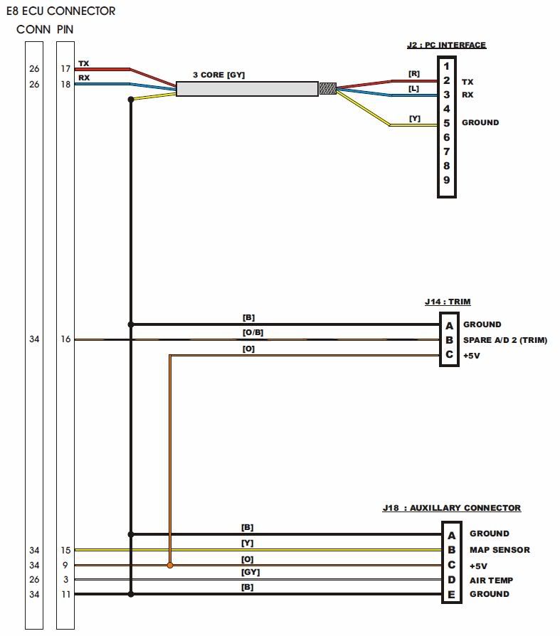

I have this Haltech Patch loom and it didn't come with any of the connectors to attach the Map sensor or the air intake temperature sensor. I have no idea what the white connector is. The one underneath I know is the map sensor connector and it is a GM weatherpack connector, but what the hell is the white one? I have already contacted the place I bought it from, but I always get the "we'll call you right back." They never call back. I've tried three times. Also no word back from Haltech either.

White connector is for MAP and AIT. Black connector is actually a spare, although it looks like it's for MAP.
