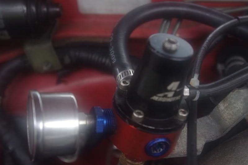

fuel pressure reg cleaning
Can you clean a fuel pressure regulator? or when there done there done? I have a Aeromotive reg and the screw is almost completly flush and is only reading at 22psi. Thinking it might be cloggged. The car runs fine but has trouble starting and idles at 1500rpm, could that be the fpr? This setting been like this since I bought the car in February...but then this happend yesterday(see question 2)

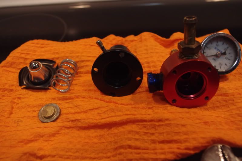

I dont know why the pressure is so low, it doesnt seem clogged. I mean there is nothing to this thing. As it sits in the pic, its 22psi. Since I got the fpr with the car, is this the right fpr. I was told it for a carbureted car.
TAKEN APART..NOTHING FOUND CLOGGED.
Does anyone know if this ball is supposed to move or rotate? becuase this one doesnt.

Alright, I called Aeromotive and they advosed me that I had there universal model which is for carb and efi. It comes with two springs, a low pressure spring(0-29psi) and high pressure spring(30-70psi). Mine had the lower pressure spring in there for some from the prior owner. I ordered the spring kit so well see....
