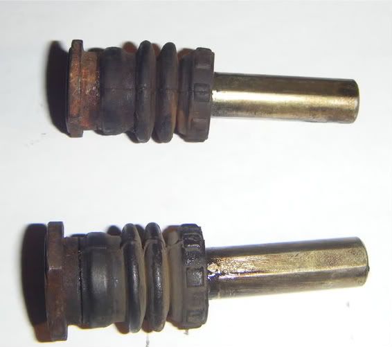

Mine were doing the same. Looks like one of the guide pins were seized. I had to extract it using a method I found on Google, Re-lubed it and problem went away.

Took off the rear brake brackets. Thoroughly cleaned the sliding pins, and used SILICONE gel/paste DO NOT USE GREASE. There was a lot of rust colored crust that came out in the brake cleaning fluid.
After doing the sliding pin maintenance, I backed the ebrake cable's adjustment nut all the way to the top on the hand brake and disconnected the cables from the rear calipers themselves.
I drove around with the cables disconnected and the issue went away. No hot brakes, no dragging, nothing.
After that was established, I reconnected the brake cables, and adjusted the nut by feel until there was minimal play, but no tension- in the ebrake handle.
Car feels much better now.
Only thing I need to do is replace the fluid since I poured old brake fluid into the system after changing the master.
