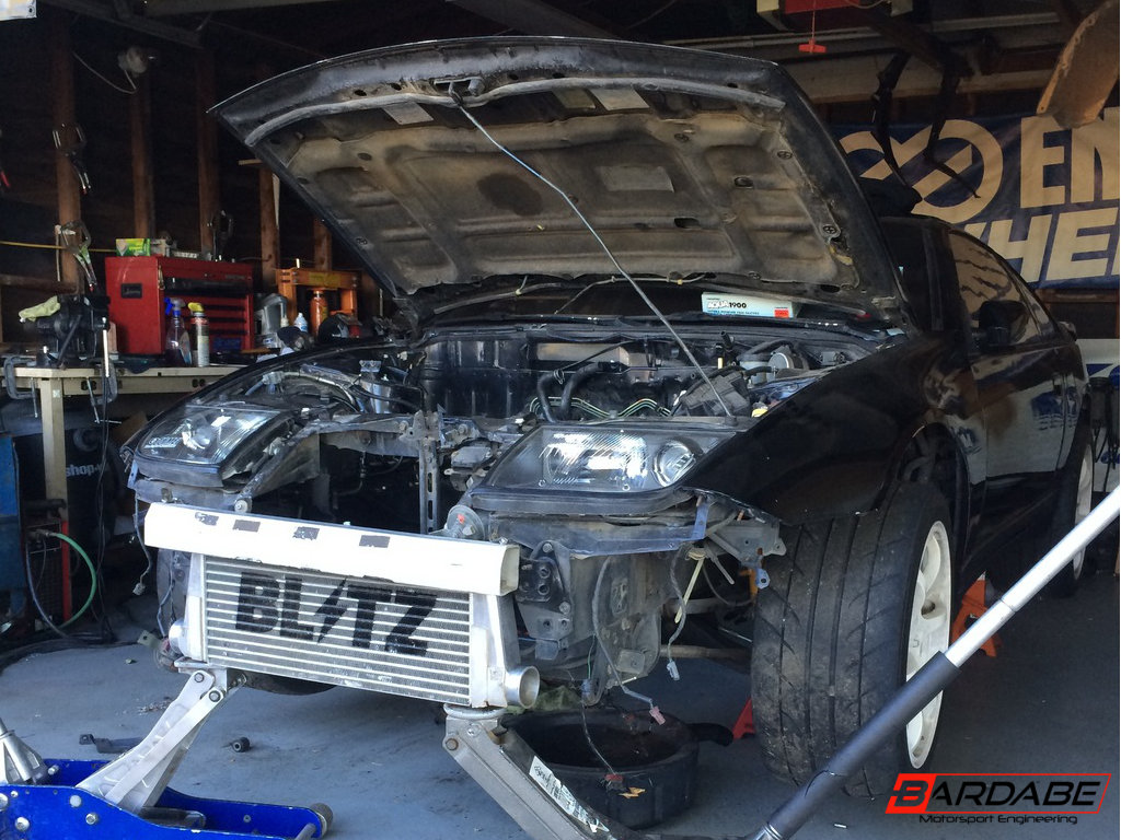

Bardabe's Project SR-Z32: SR20VET Chronicles
~~~~~~ EDIT: Photobucket fucked my build thread, like they did for half the internet SO I'm re-hosting all the pictures and will slowly fix them. ~~~~~~
I'm not very active on the forums, I spend most of my time working on customer cars so it's actually not often that I get to turn a wrench or burn metal in my own personal car, specially now since the Z32 shares custody of my finances with my R32.
anyway, bought a VVTi 2JZ From LA JDM, and a bunch of goodies for it. ID1050's, Maverick CD009 Adapter, Maverick Flywheel, BWS300, Timing belt and such. It seemed like a great idea at the time, there wasn't very many JZ32's floating around the web and the JZ is a prooven work horse.
-Juan

Expect some updates over the weekend, I have decided to make a custom tubular cross member to be able to sit the engine as low as possible to avoid any hood notching and retaining maximum oil capacity. don't know how far I'll get since we have a holiday weekend and my access to materials will be limited, BUT i do have this teaser from last night (got bigger turbo)

I got to pull the engine out of the clip and sold the transmission. I still need to get rid of the five lug, the RHD stuff, Speed sensor & basically everything else from the clip that i do not need for the swap. while that happens I put the SR on the stand and took it apart. I stripped it of all components this past weekend and took the head off. from initial looks i was a bit skeptic since the engine oil looked dirty. I have never had a bad engine from my supplier so I took the head off and just as expected the cylinder-walls pretty much look perfect. I was able to clean the top of the pistons with a simple spray of parts wash and a rag, only one wipe and the pistons were pretty spotless. since I'm re-sealing the engine and changing out all the gaskets I replaced the factory composite gasket with a 1.5MM Tomei head gasket & brand new Nissan head bolts. I also re-sealed the front timing cover / oil pump, I still need to re-paint the valve cover so i can finish sealing the engine so I can clean the outside of all the old leaks & that weird white calcium build up.
I've been stashing parts for quite sometime now, I should have my bell-housing back from machine shop sometime this week. (Z33 gear box) so I can mate my transmission to the block and begin fabricating motor mounts. just today my ATS Clutch arrived from Japan. (thank you Yasu!) so I'm super stoked for that, i don't think I'll ever have to worry for a slipping clutch. thanks to George over at Maverick Motorsports I won't ever have to worry about breaking a transmission thanks to his SR20 to Z33 adapter as well. I hope to this week finish bleeding the lifters & get the valve train all back together. I still need to make up my mind on what I want to do with the valve cover, ultimately I'd like to send my Valve cover to MCR Factory when i forge the engine & do the top mount turbo but i need to figure out something for now.

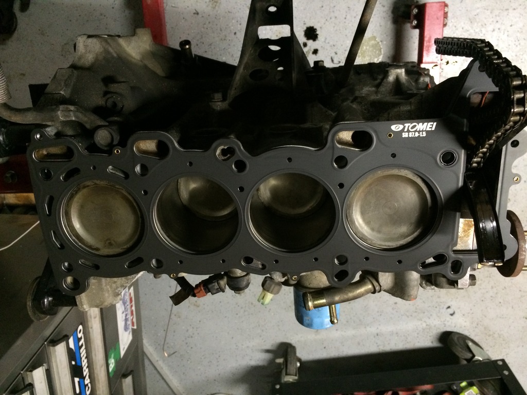

Unfortunately I haven't received my bellhousing back from machining so I can make motor mounts and other fab work so I've had to compromise. This weekend I was able to make the hangers for my exhaust, I also took the apexi gauges and installed them. I re-loomed the apexi harness with milspec loom for a cleaner look through the windshield and ran all the wiring. I also had a chance to mock up the Intercooler mounting and I'm really thinking of making an aluminum bumper beam with tabs for the IC. Not sure how traditional I want to do the mounting on that.

Freeing up weight and complexity on the front is the way ahead me thinks!
