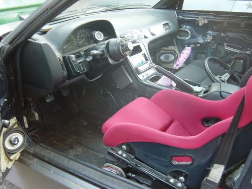

Problem with the S13 and sliders is that we have the huge hump on the inside by the shifter. It forces any slider mounted more then 1/2 way past the middle of the seat to sit too high. OEM Seats have a cutout for the slider and sit your butt below the inside slider. NON-OEM setups ussually put the slider in the very middle of the seat at the same height as the outside slider. You then build a extension over the the inside of the seat to attach the slider to the seat. I did this on my seat and it works fine. A couple people make these "Low Profile" type sliders already. Bride is one of them. You can then adapt your seat to that slider setup if you like. Freshalloy.com has a couple threads that are helpfull if you like. I have a couple pics in my gallery over at sr20forum.com that you can go take a look at.
