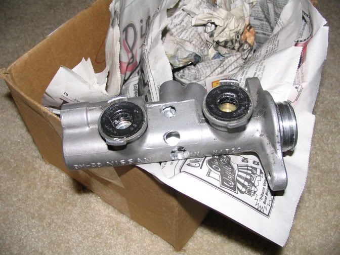

im having trouble with this. Its harder than I expected... AND the MC in that pic aint from a s13... I already sliced into the fitting and havent begun my 2nd or 3rd tries. Already broke one cutting disc too [but thats cuz i overtightened it to the dowel thing]... SAFETY GOGGLES GOGGLES GOGGLES!
Yeh... also heard some Nabco MCs already have the fitting, but I bought #46010-30P22 Manufacture date 7/89 – 7/90 (17/16" TT Nabco)
from Kragen and it didnt have the fitting...

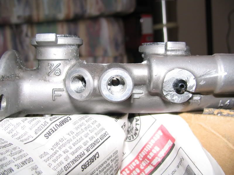

I just got my fitting out tonite after drilling 3 3/8" holes. AND I used a s13 MC, which is totally shaped different, and has 2 paralled cylinders welded together, so it has a lil more complex plumbing. Ill get pics of the destroyed MC... cuz it looks a lot easier for s14 guys with the fittings all on the end. S13 ones are in the middle harder to access...

icic... heres pics of my butchered s13 MC
The bottom most hole is the only one I really needed to drill, but the other 2 were so I could see stuff better. Its NOT straight through. There was barely a straight path to that middle fitting.
*I coudlnt choose the fitting on the end cuz I sliced it a bit :/
