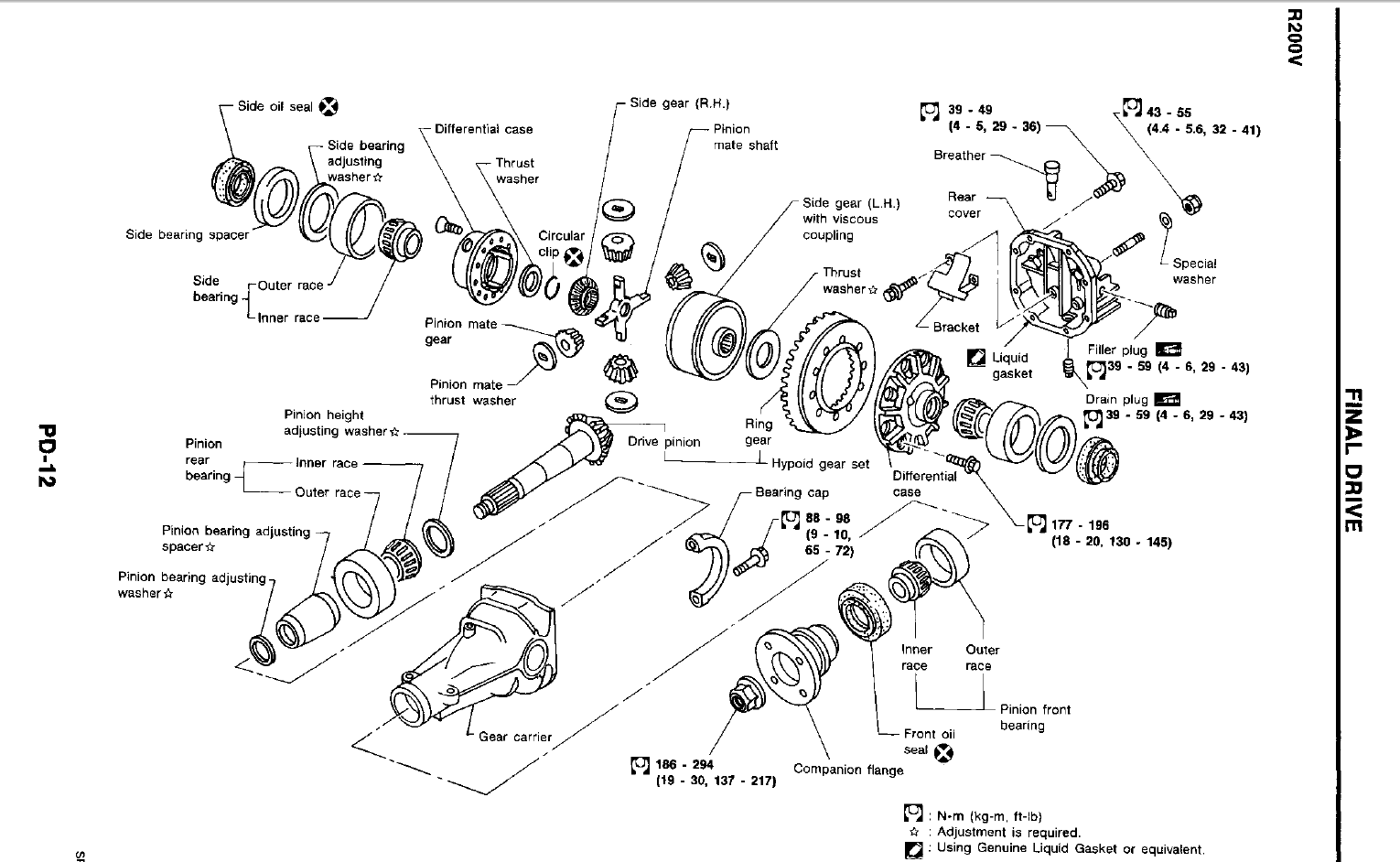

ok i just got done shimming my VLSD in my s13 and have a few torque spec questions
first what are the ring gear bolt torque specs???
second what are the carier bearing cap torque specs???
finally whats the backlash specs??
i have searched for the past half hour and cannot find any answers!!! maybe i am typing the wrong searh words in the search bar!!!

i know that the the gear ring bolt torque spec is 137 lbs or somewhere in that number area.

awesome!!! thanks for the diagram now if anyone has the back lash specs i will be in like foreskin!!!!!! thanks for the help!!!!
