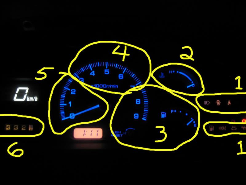

Well, I thought that I would add to this old-ass thread rather than making a whole new one, try to consolidate this information in one place instead of spread all over the place. I installed JDM cluster on my s13 recently, and the lighting was dimmer and looked a little pinkish, so I thought I would try some wide-angle LED bulb-replacements. I love the way VW gauges look, so I tried blue first.
Here is how the cluster looked originally:
I first replaced all of the bulbs with the blue LEDs, and it was just too much blue. Also, the odometer and the legends for the warning lamps were pretty hard to read. Another side effect that I hadn't considered before is that my redline completely disappeared. I was hoping that it would be brighter than the stock bulbs, because they were pretty dim, but unfortunately, they are about exactly the same brightness.
So I changed the odometer and warning lamp legend lights back to the bulbs for now.
Next time I order some LEDs, I am going to try white, according to their data sheet, they are about 50% brighter than the blue ones. I'll post results again when I get them. I also plan on replacing the warning lamps with LEDs as well.

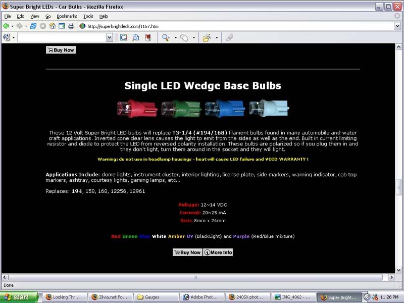

I got the bulbs from superbrightleds.com. I used the "Single LED Wedge Base Bulbs" (#194/168 replacements) about 3/4 down the page. Next time I order from them, I will probably try the white versions of the same LED bulbs as well as some of the 5-LED wedge bulbs. Because of the way the light is distributed across the gauge faces, you have to use wide angle leds.
And I know the thread is old, but there is good info in here, so I thought I would add to it.

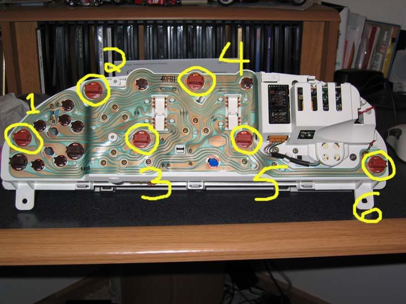

Posts: 4,702
Sorry it took me so long to get back to this thread, I was out of town on business all this week. Anyway, these are the bulbs that I used:
This is the back of the digital cluster. I don't know how the analog cluster differs.
The lights that are so professionally circled are the primary illumination lights. The blue one on the bottom I believe is for the clock and the dark brown ones on the left are the individual warning lamps. Number one (1) lights up the legend for the warning lamps (see the next pic for reference). Number two (2) is for the Temp. gauge. Numbers (3), (4), & (5) in combination illuminate the tach and the fuel gauge. In the picture below, I've circled the tach needle in number 5, but really I think it is just illuminated by all three, though I am not certain. Finally, number (6) lights up the odometer and the trip odo.
What you see on the back of the cluster are actually little sockets that the bulbs sit in. They come out with just a quarter turn, and then the bulb will just pull out of the socket. I believe the smaller bulbs are #73/74 bulbs, though I haven't found any confirmation. If anyone can confirm this, let me know.

Sweet, thanks for the info. What are all the black bulbs around #1? What do they light up?
