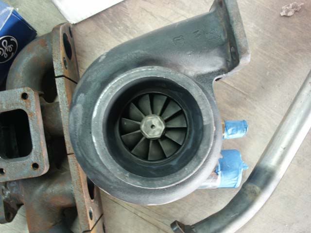

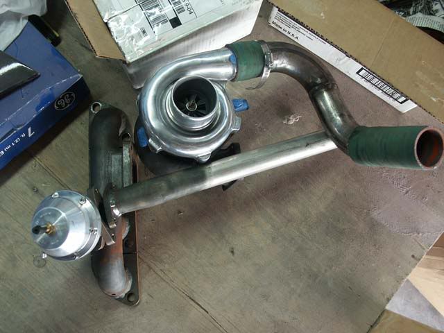

Ok..the kit I plan on purchasing comes with
JGS manifold
Tial waste gate
Some garrett turbo with exhaust .84 a/r.. I can't find the intake a/r
Waste gate dump tube
What do you think the kit is worth, and how much safely to boost on stock ka24de? I've heard 10psi is good. I'd like to see what I can do with stock KA internals, before I go with forged pistons/rods.. I'm not really looking for low 1/4mile times... just a bit more power. You think this kit would be good for me to beat the shit out of on a sunny Sunday afternoon?

jgs - $200
tial - $150
turbo (my guess is thats a t4) - hard to tell depending on condition. would guess $400-500 if its fairly new.
so around $700-900 is whats that stuff worth
now, i would not run any of that without additional fuel, and honestly, imho that turbo will be way too big if you just want a little kick. I would stick with a T3 or T3/T4 at most for a general street application. but thats just me.

Appears to be a t4e housing.. with a full t4 tang(ental) housing. It's very used-looking, so the turbo is worth ~$300 to you in my opinion.. may go down if the turbine housing is larger than .84 A/R. The other prices Kreator hit on the head.
$650-750 I'd say.

eh ill bring my stuff for comparison... if it is a t4... then it wouldnt be ideal yah know what i mean.. sell it to a honda guy they love to go straight...

The turbo is faily new.. there is no shaft play that I could tell with out a mic.
I do plan to run a walbro for 255..and an SAFC.. along with the basic necesssities to run the turbo.
