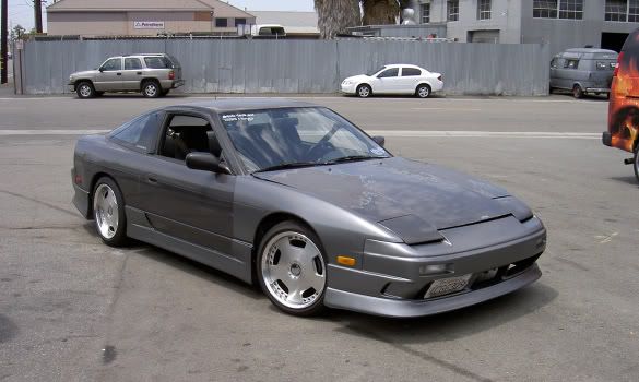

i have 215 40 17 on a 9 for front wheels/tires
had this for the past year or so.
