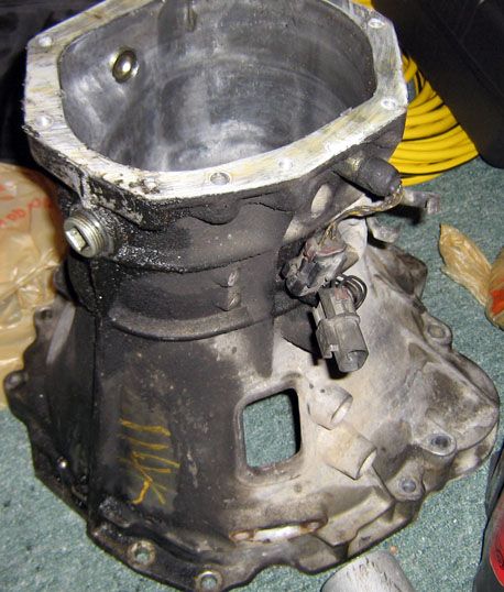

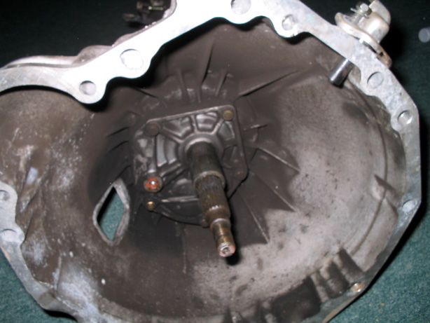

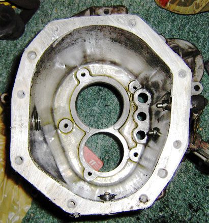

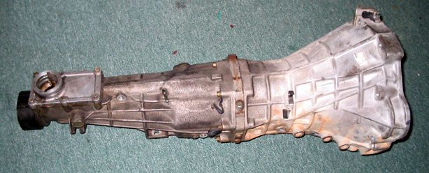

All KAs and SRs and VQs have the same tranny, just swap out the bell housing.
Its like 8 bolts?

Its a little harder than that but very easy in general .
grab a 240sx chiltons manual or fsm, (USDM) should have a section on tranny rebuilding etc, and will describe how to remove the bell housing for the fs5 trannys.

unbolt front cover bolts and remove.
Unbolt center bolts.
Remove bellhousing.
Reverse using RTV to seal the center and front cover. This takes 2-3 people. 1 controlling the tail section and not alowing the exposed gears to hit the ground.
