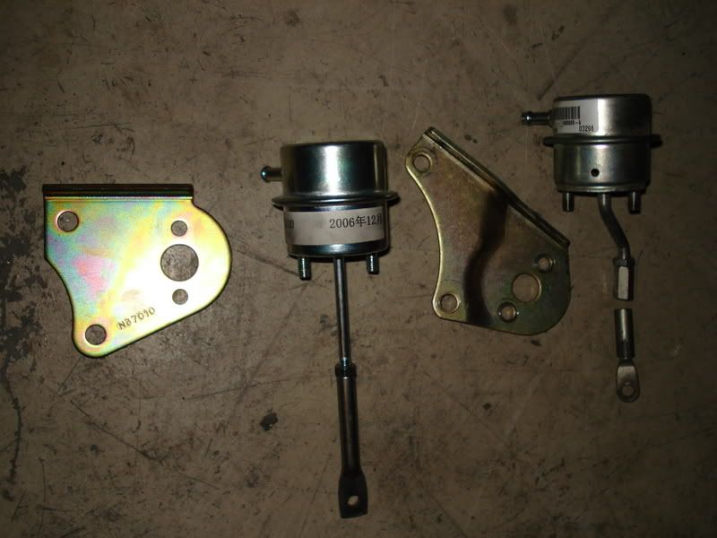

The HKS WGA is the one with the closer bolt holes and the straight arm. The stock one has the further bolt holes and the bent arm. My problem is that the HKS bracket wont fit the compressor bolt holes where its supposed to mount, the arm is too long and its straight instead of bent. What is the proper install method most people do?
To make matters worse my stock WGA fell apart at the rod so i cant even go back stock
I know i could bend the WGA rod and cut down the threaded sleeve but is that really necessary?

there are two kinds of the wastegate you got. the one on the left the hks on is for the t25 style turbos and the one on the rite is for the t28 cause there is a bend on you must of order the wrong wastegate. if i'm not wrong.

Yea i called the vendor and this wga isnt direct bolt on for the gt2871r's with the 3" inlet like mine. I will have to make a custom bracket. Ill probably use the original and just cut the rod down and bend it.
Id think by now someone already made this but guess not...

Good point. What my pic doesnt show is that the end that attaches to the WG shaft has a stud inside that has broke off at the hollow end, and it wont come out. Now the other end(the one the rod going into the WGA is about a centimeter shallow from the end. Honestly i do not know how the 2 pieces were even attached, it fell apart in my hand, maybe a centerpiece fell out and hit the ground i didnt notice.
Oh, and i did not even attemp to adjust the stock wga because i thought the wga spring itself was too weak to hold 19-20 psi to redline?
My tuner blammed the boost spike on the TXS MBC(new style). I can either return this and fix my old one or go ahead and make it work and just look at it like for $100 ill know the problem is not the WGA. Wacha think?

OK, so i called the vendor and he will take the HKS wga back since it didnt bolt up. I dont want to hassle with a custom bracket when im not even sure the WGA is the reason for my boost spike and not holding boost till redline. I figured out how to fix my stock WGA, turns out there was a loose stud inside the tip. So im gonna try to adjust it (tighten it) and see how much itll hold w/o spiking past 19psi. If this DOES NOT WORK i have a couple of options:
