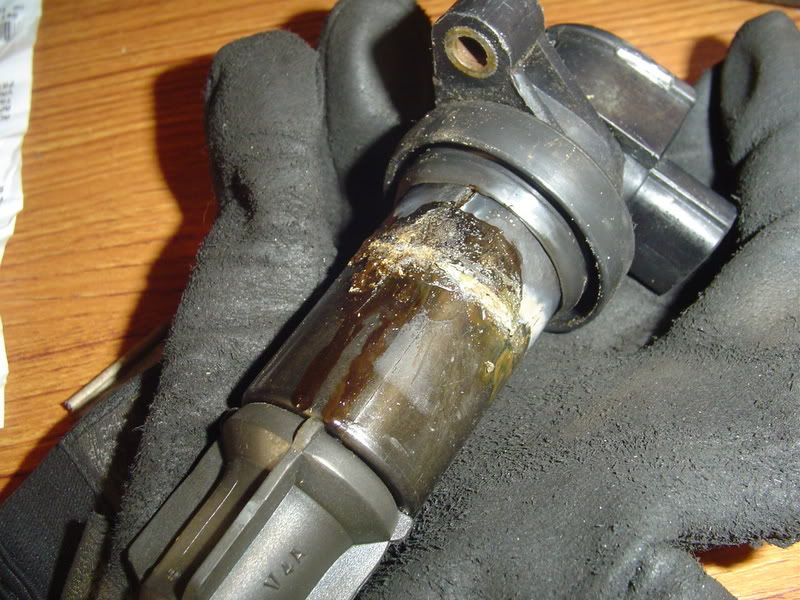

2 of the coils didnt want to come out like it was hard to get out. i dunno what happened to it but the plastic formed into a lip and now its hard to take out. i got 2 of them out. the head i dont what to look for since i took off the valve cover. any tips or things i should exaime. my next step is to drain oil and take of oil pan.

hmm looks like when one of my coil packs exploded.. the coil pack is filled with some kind of horrible smelling fluid that turns into glue when they crack.
This is a picture of my coil pack.. It exploded, horrible sound.. the car was firing on 3 cylinders... parked it and when i popped the hood the smell hit me it was horrible!!!!! anyways.. got the car home.. the next morning i go to troulbeshooting find out my #3 coil pack would not come off.. i had to use pliers to pry the bitch out.. then had to clean all the crap off so my replacement coil pack wouldnt also get stuck on.
did u hear any sound like a rod knock or anything. when i was drive i heard an expolison to, then thats when the clicking came in to. do u think its the coil pack or something internally.

very hard to say about the clicking... the coil pack and the stuff on the valve cover looks just like when it happened to me. This of course doesn't mean something else may be going on with your set up.
once i heard the loud pop and didnt have a clue wtf happened.. i shut the car down. The next time the car was restarted I had replaced the coilpack with 1 of the spares I had and fresh plugs. It ran like normal. I went back through trying to troubleshoot why it popped in the first place and all my wiring test showed no problems with the coil pack wiring or anything.
so i chopped it up to the 6-7yrs of abuse the motor has taken from me.
