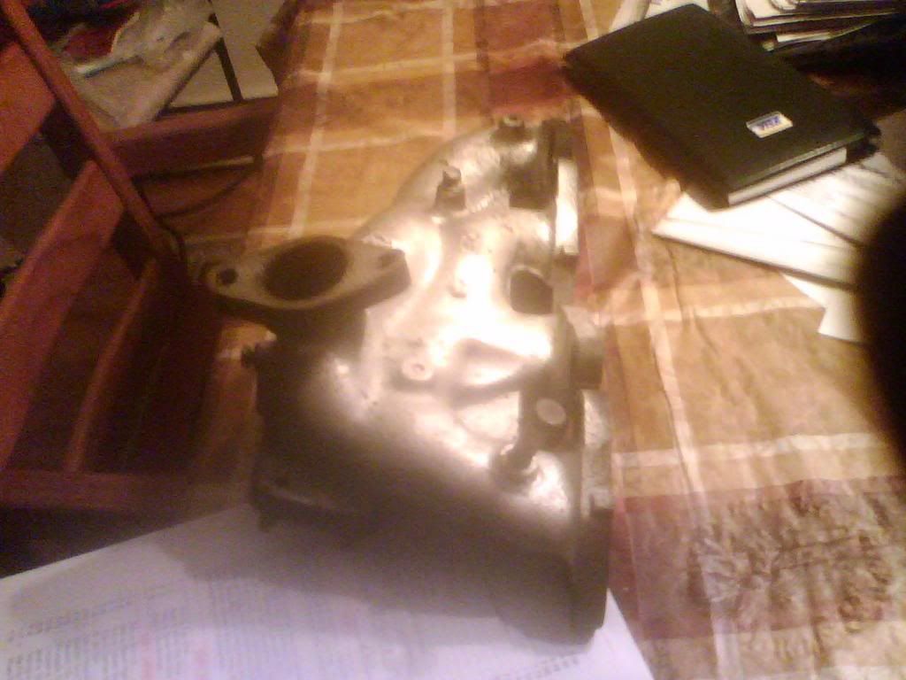

I had the exact same issues, but worse... boost would climb to 1.8 + if we kept our foot in it.. More boost w/ more rpm. no way controlling it what so ever.
We tired everthing in the book.
-Removed Boost controller (less variables)
-tapped different boost soruces. (To see if acuator would open at different times)
-Switched to HKS acuator. (no better) , adjusted length to look at stroke and movement.
-Removed Acuator completely and saftey wired waste gate door open: No Change!
-Pulled Turbo, ported wastegate port and surrounding area. A little better. but sill 1.7-1.8 bar..
-Pulled turbo again, more porting, flange and turbo flange. Mildly better.
This was all with the wastegate port WIRED wide open the whole time.
Ended up just pulling the dam thing.
-Stock turbo back on , held 1.0 bar all the way to redline.
My guess is givien the right cam' set up and few other supporting mods, the Garette with a internal gate's design is just crappy and can't flow the amount of air need to controll boost. Everyone that worked on the car han Never seen anything like this. Would it have happened with the HKS version (GTRS)? I guess i'll just have to drop 2k and find out....lol
Good luck

Are you sure it's boost creep? I'm thinking it's just the slow response of an internal wastegate. Even an external is pretty unresponsive by itself. I'd suggest getting an electronic boost controller (set that to 17 psi)and setting your actuator to stock.
It's not like a wastegate set at 9 psi will cause the turbo to slam into 9 psi and stop. It'll probably hit 6 or 7 pretty quick and then maybe max out at 7.5 or 8. It's just the inherent design of a wastegate. It bypasses more and more exhaust as turbo pressure builds.
serturbo is offline   Reply With Quote

I've never seen a 2871 not hold within 3lbs on on an internal gate.
cams or otherwise.
theres something wrong with your setups.
figure out what it is.
Trading a 2871 for a GTRS would be about as retarded as I'd expect from zilvia but damn luddy.
when half the 240sx community does it just fine, and your shit fucks it up don't you think you would try and find the problem with your car?
god knows you ricers are just looking for an excuse to add a tial to your mods list.

Yes it would! On my s14 with the GT-RS I had boost creep so I was limited to 1.15 bar using the Blitz i-color sbc boost controller. It was rock solid stable at that level but anything higher saw boost going to the moon. GT-RS is the same turbo as the 2871r .64.
I was gonna try a greddy elbow which i had before the turbo upgrade. G-dimension pushed a megan elbow on me; they said the greddy elbow wouldn't "fit" which is complete bs, all that's needed is to trim the divider plate but I sold the car before I could try it. Jon at HKS suggested the YF turbo elbow.
-Norm!

Some guy on Fresh alloy fixed his creep with an intake
It still creeped a tad for Def. Main reason for intake change was due to lack HP found.
Originally Posted by McRussellPants View Post
2871 shouldn't be creeping.
They certainly do though...
I had mine adjusted with no preload. Holds 12, then 14, then 16 then 20....
Did it when new, does it now. Changed some things around, same issue.
I'm going to try a new vacuum line once more (this time, using the fabricy coated vacuum line type, and go from three. I'm certain it won't solve anything though.
Exactly why I'm putting it on my stocker. I wish I could control 20 psi during HPDE on street tires. I wish I could afford 800 bucks in tires to run higher boost and not worry.
