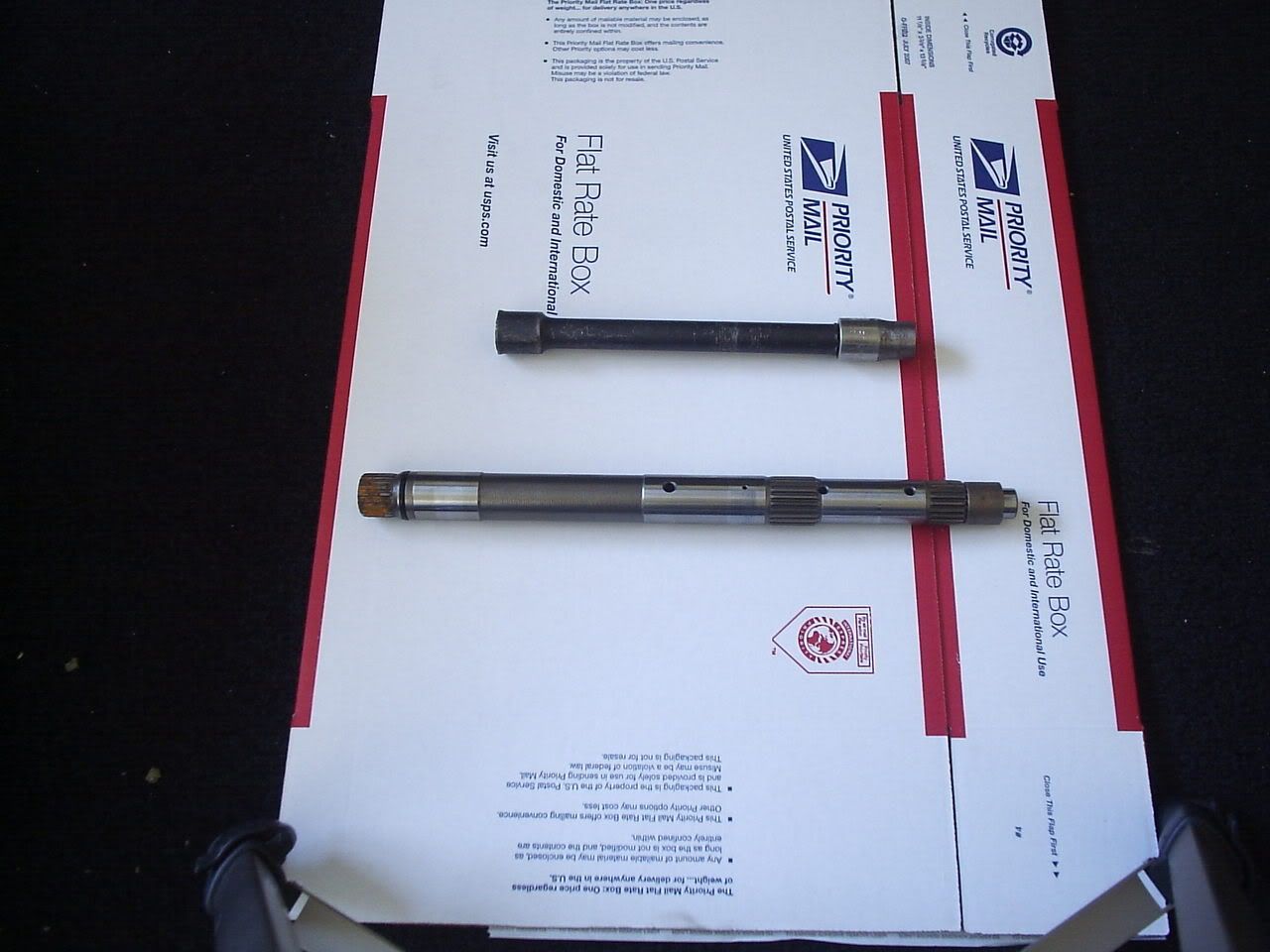

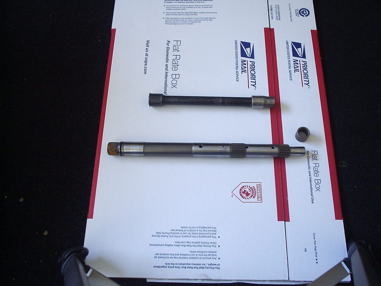

Here what I use when im doing an auto to 5 speed swap I think some people will find this useful:
To remove the auto pilot bushing I use a 1/2" extension with a 9/16" socket that has been slightly (modified) grinded to fit snugly into the auto pilot bushing and then simple push down and and pull up repeaditly until it wiggles it self loose, this works good!
Next to install the manual pilot bushing without damaging it first I soak the pilot bushing in motor oil for about 15-20 minutes for godo measure, then from my auto transmission I jack the input shaft from it which pulls right out (which can also be seen in teh pictures) use this to install the pilot bushing by placing the manual pilot bushing over the shaft and gentle tap with a hammer or mallet.
I did it just like UNISA on my auto SR. I actually was in the same boat after I couldnt pull the pilot bushing using 2 diffferent puller and slide hammer etc.
I searched here and found that someone managed to do it by inserting a pipe that fit snug on the bushing and start wiggle it up and down. When I saw that I thought it was impossible and ridiculous but decided to try it anyway since the only option left is cutting/drilling it out.
I used my craftsman jack handle and start wiggling it, after about 10 mins I can see it start to sticks out and finally in 20 mins it was out. I didnt believe my eyes but it works.
