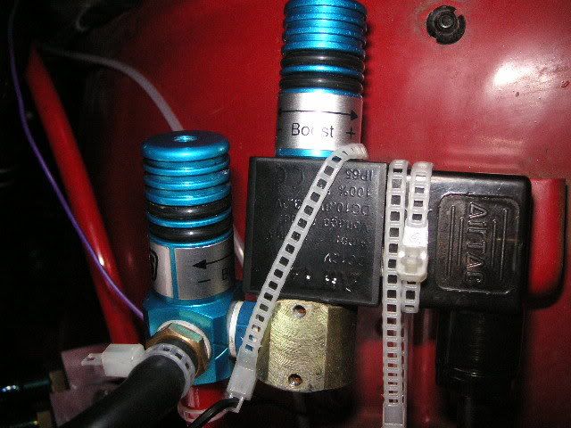

turboxs boost controller
the red hose hook up to the wastegate and then the black hose into the intake....

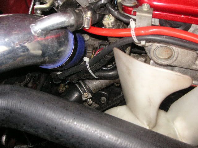

see the black hose into the bottom of the intake...
enigine bay kind of dirty......

Turn the adjuster screw on the first stage (the blue thing closest to the vacume lines) counter clockwise until the boost comes down. The adjuster screw is down in the hole on top of the blue part, the controller should have come w/allen keys.
...or do you want more boost, in that case turn the adjuster clockwise till it goes up. You may not see much more boost on a little T25.

i close both of them all the way down. i turn 4 or 5 turns on the first blue one and test it. it goes 13-15psi....the second blue one is close down.

Looks like your black vacuum hose is attached to the bottom nipple on your intake. Thats wrong, attach it to a top one. The bottom one doesnt see boost, just vacuum iirc.
so should i just switch them? the red hose is connect to BOV, Boost gauge! the black hose is connect to boost controller into wastegate.

No, you wanna cap off the bottom one, its for the stock carbon canister and doesn't do any good other than that. Ideally you want a nipple on the hot side of your intercooler for the waste gate, then use the top ones on the intake mani for BOV, gauge, FPR, etc. You just gotta use T's unfortunately.
You can get a nipple welded onto your hotpipe near the turbo or get one of these quicktaps (link below) and stick it in the coupler coming off the turbo and run that line to your MBC --> Wastegate
http://www.atpturbo.com/Merchant2/me...egory_Code=BCS
Temporarily, you can pretty much T into either top line, but adding a nipple to the hotside is the best way.

alright i will try to weld the nipple to my hotside pipping later on the day. ill keep you updated if i need anything else. thanks for your help emersonLP!
