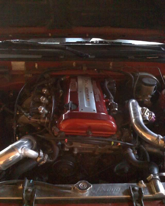

For the Love of Nissan Just recirculate the Bov
For people that don't know:
Vented to atmosphere is not a good option for nissan tunes.
you will have running issues that can be easily remedied by a simple recirc hose.
believe me, i went vta at first and never again on the altima. reliability is on par with a non turbo setup, has great blow off sound still and runs like a champ - 11lbs all day long.
recirc it, youll be stubborn about it at first, but its the right thing to do and youll be much happier in the end.
this is stickied somewhere but here it is again.
From: "Ben Pila" <[email protected]>
To: <[email protected]>
Subject: Re: BOV Setup Information
Date: Mon 10/29/07 05:42 PM
At 05:35 PM 10/26/2007, you wrote:
Hey Ben, one more question I should have asked before... Is the JWT
tune designed with venting to atmosphere in mind or with
recirculation in mind? I currently have mine venting to atmosphere,
but Im hearing that I might have idle issues with that setup.
Thanks
Jay
Hi Jay,
The Nissan control system was not designed to run a BOV to
atmosphere. There is no way to make the ECU work with this as the
amount of air flow in the system that is lost if an atmospheric BOV
opens is an unknown amount to the ECU. Once the air flow comes
across the MAF sensor, the ECU expects all that air to be in the
system and adds the fuel based on this amount. So if you do not want
to have the stalling when coming to a fast stop and/or the rich
conditions between shifts, we recommend you run a recirculation type
valve (also known as a compressor bypass valve). It might be
possible to convert your existing valve to the proper type. Check
with the company that made your BOV for this. Note that the air flow
when recirculated, should dump back to the inlet side of the turbo
and ideally aim at the compressor wheel in the turbo inlet. This
also helps keep the turbo more responsive between shifts.
Best regards,
Ben Pila (Technical and Sales Support)
Jim Wolf Technology, Inc.
212 Millar Ave
El Cajon, CA 92020-4219
(619) 442-0680 Mon-Fri 8am-5pm PST
(619) 579-8160 24 hour fax
JIM WOLF TECHNOLOGY, INC. / NISSAN PERFORMANCE / NISSAN RACING /INFINITI PERFORMANCE

im running a vta bov too, the only issue im having is that when coming to a stop my engine will start to bog down almost like the ecu wants to kill the motor, but then the engine will start to make its way to idle point, like mentioned above in the op email.
This idle air tube you are talking about, where is it located? (on the throttle body?) where does it hook up to? maybe this may solve my problem.
DisEpyon is offline   Reply With Quote
Old 12-02-2008, 08:52 PM   #30
LongGrain
LongGrain's Avatar
Location: Midwest
Posts: 2,741
its a big tube, like maybe 1" or so, its on the TB i think, or maybe just the intake. i dont have my car here to look at it. but there should be a hose going from that to your cold pipe.
heres a pic of my motor, you can see the tube, just not really where it goes.
LongGrain is offline   Reply With Quote
