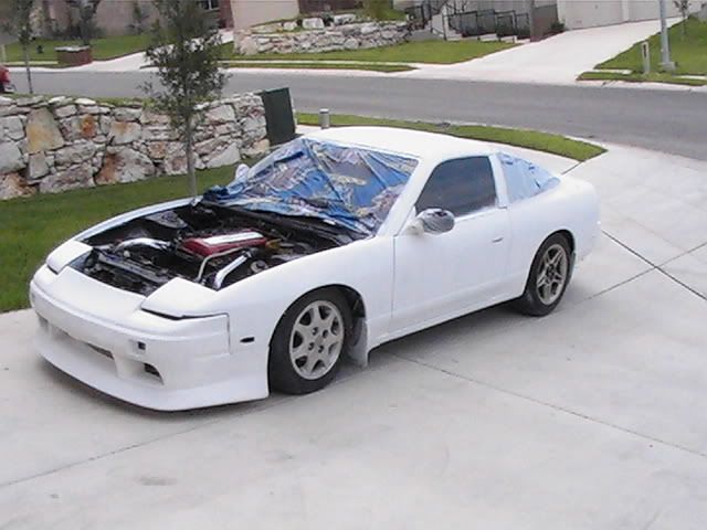

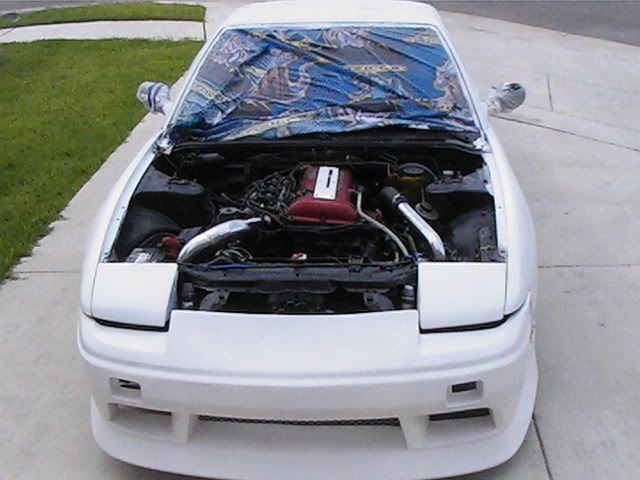

Now im tryin to mount my bumper up right so that way its sturdy and not sagging lol. I dont have a front core support.
Now what are some of your ways that you use to make the bumper flush with the rest of the car lol.

the part inbetween the lights needs a metal bar , if you have a metal trip drill some hols in it and use that
even after i murdered the bumper it still sat stright ,
make a little bar

Yea you see those two pieces where the hoods rests where the rubber stoppers are at. I dont even have that anymore, so i'll have to make some sort of makeshift metal strip and L-bracket, hmmm
