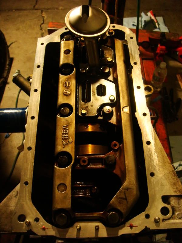

This is how clean I cleaned the Oil Pan touching surface.

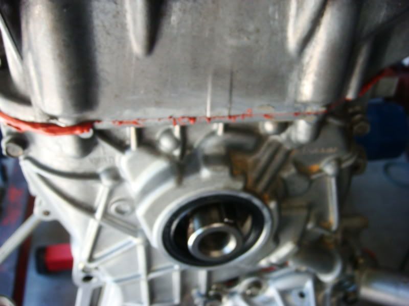

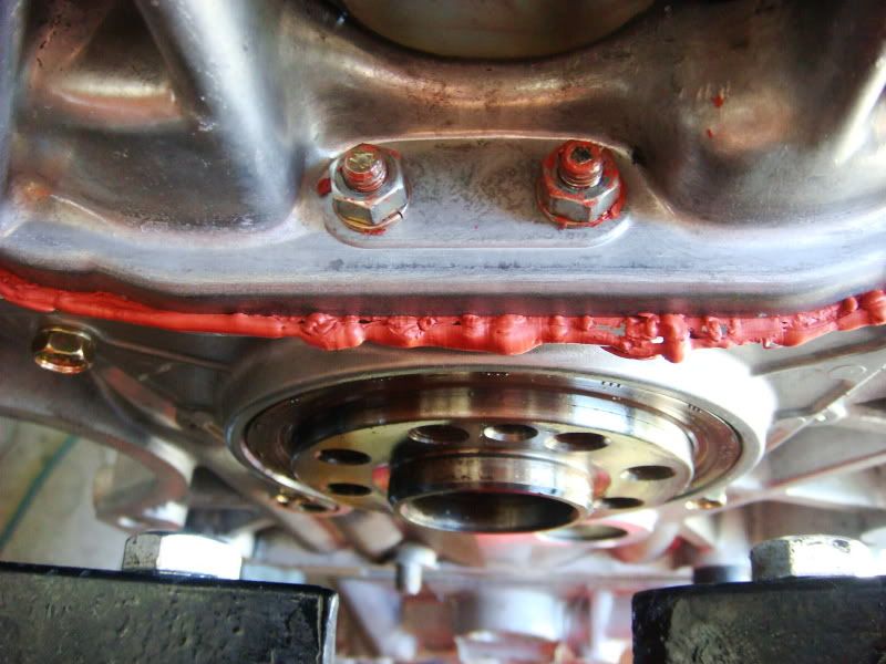

This is the rear of the motor. The RTV has became solid, but you can see, it is separated.
The RTV that squished out at the front of the motor is appearing the same and it actually fell off.
For peace of mind, should I redone this? I worry about the inside of the motor would appear the same, which fell off inside. I wouldn't worry it has a few drips of leak.
