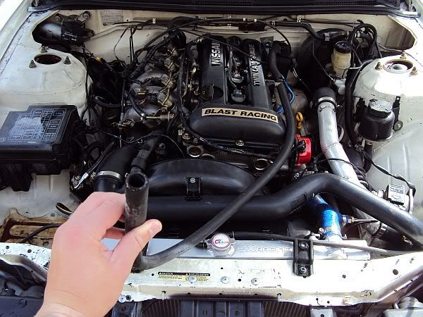

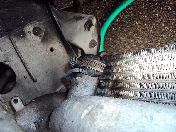

Alright guys I am a noob in this community but my first concrete tech question is that I have some kind of boost or vacuum leak that is creating serious lag around 4000rpm. It is like the motor wants to go but something is holding it back big time. Now there is a pcv hose coming out of the valve cover that doesn't go to anything does anyone know where it goes? Also, there is a piece of rubber with cracks in it and a hose clamp capping off an outlet on the wheel well side of the intercooler. what is the reason for that and could that be one of the problems. PLEASE BE EASY ON ME GUYS

That goes on the intake side.People usually put a catch can attach to that. But thats not the reason why your car is bogging. Try cleaning the MAF and TB, maybe the IACV also. those are the common causes of car stuttering. Could also be a faulty fuel injector.
I cant quite till what that is but is it on the intercooler pipe? if so, thats more then likely your problem if it has cracks.
almost sounds like a boost leak.
