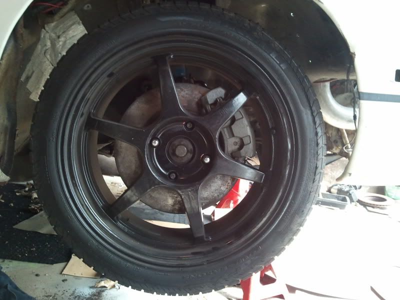

Old 03-12-2011, 05:38 PM   #20
mikey976
mikey976's Avatar
Location: North Jers, Parsippany
Posts: 215
mikey976 is an unknown quantity at this point
Send a message via AIM to mikey976
finished product
KAe-T goal 400whp with A/C - Hatch VH45 track duty - Titan VK56 tow rig
