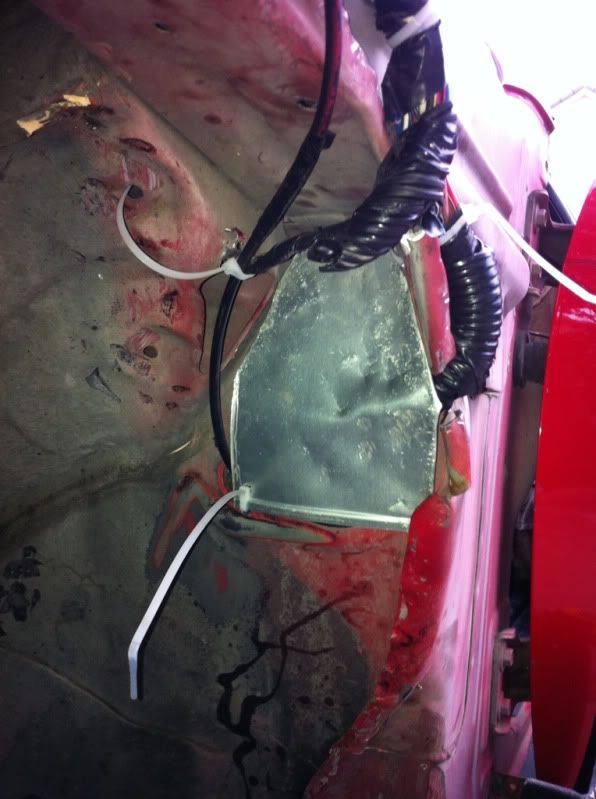

TUCKING wire harness in s13's like a baws
i tucked my harness 2 years ago when i had 17's and did a shitty job, so here i am REDOING it..
DON"T do it like that, unless you want to re-pull fender and re-tuck in the future, when you get big ass wheels in the front.
TODAY I GOT DOWN TO IT...
STEP 1 - REMOVE FENDER
STEP 2- look at the saggy ass harness rubbing on your 18" wheelzzzzzz, actually had to repair some damage, tire started rubbing through half the harness, my car actually shorted out pulling out of autozone in the middle of main st, fuck that never again..
STEP 3- remove plastic tube shielding around harness.
STEP 4- THIS is what i wish i would of knew back when i did it the first time, but if you cut out a slot, the harness tucks perfectly.
STEP 5- ZIP TIE THE FUCKER to random holes, like this
then bend the lip up to act as a barrier between wheel and harness..
STEP 6- repeat to other side of baller lambo aka s13
STEP 7- PUT THAT ISH back together and drive it how its supposed to be driven...
by parking

^^ doesn't that interfere with your fender?

this is still pretty ghetto
why not just run it throw the engine bay (still ghetto)
zipties are not forever

both my fender harnesses are tucked into my engine bay. only part that worries me is where the wires come out from the cabin

This will still rub if you are boss enough. Run it in the engine bay and never pop your hood.

I would be worried about the metal edge of the slot that you cut out rubbing through the harness.

i did mine this way but i also hammered the pinch weld up and out a little bit more for clearance. i figured someone else would've thought to cut it as well.

i was running rather large tires so i took it one step further.. worked great.

I suppose you could always coat the edges with some sort of liquid rubber, or maybe an old rubber hose you could slice in half and stick on the edge?

this really only works when you aren't using a fender brace... otherwise - fender brace is in the way and routing options are limited...
cut/reroute into engine bay is by far the best solution - albeit a tedious process its so worth it

Maybe I am doing something wrong, but this does not work! Maybe if you took out the dash and disconnected the while harness!
http://imageshack.us/photo/my-images/842/zilviasig.jpg/
harrypotter is offline   Reply With Quote
Old 09-18-2011, 05:29 PM   #28
Shift-240
Join Date: Jan 2006
Location: New Orleans
Posts: 185
Shift-240 is an unknown quantity at this point
It does work. If you're smart and analyze the components and wiring, you'll see in-fact that the dash does not need to come out.
How do I know? b/c I did it a few weeks ago. I routed my harness just like the OP and shit got all fucked up from going ham on the track.
So I bought a new front chassis harness and ran that shit in the engine bay and didn't remove my dash.

I pulled mine through just fine. Disconnect the white connector and work it. I'm putting my relay boxes in the glove compartment.

I did mine this way (both sides done the same way):
