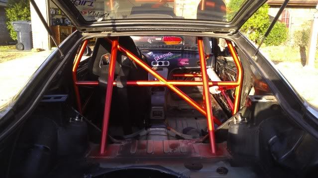

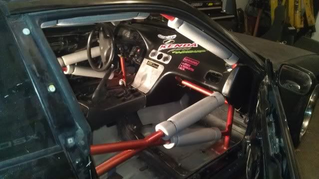

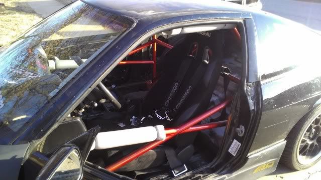

here are a few pics of mine. i put the dash bar lower then most cause i retained the stock one. No it does not come in contact with your shins, i have had people 6'5 ride with me and they were just fine.
91ka24 is offline   Reply With Quote

Thanks for the pics and the info i have a performance shop but i would like to know how long it took you to complete this 100%, approx. hours. And what special tools were needed? Really appreciate the pictures looks awesome. (also the car is purpose built not a "cool guy racecar" haha)

i did all the cutting, notching, and tacking it in place. that took a total of about 16hrs or so. again, i dont do this for a living lol. then my friend tigged it, which took about 13hrs. now if you were to mig it, it would obviously not take as long. all i used was a level and angle grinder to do my notching. hope that helps

is it just me or do those door x bars look rediculouly high? it must be a pain to get in and out with that cage... why did you weld them in so high?

Ahhh there not that high. Could have made em lower but i like em where they r
