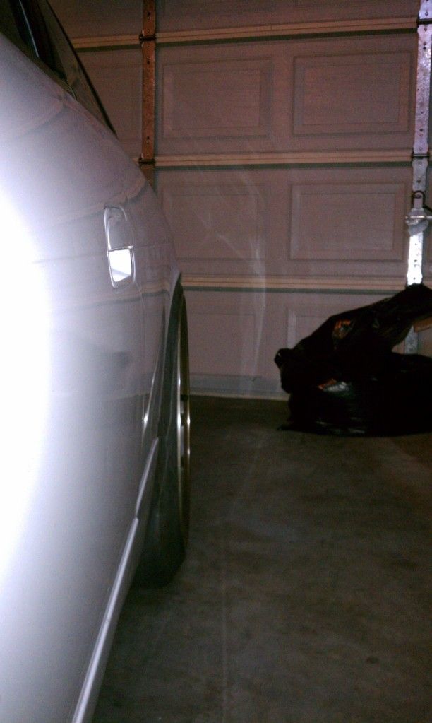

1990 S13 LS1 swapped. Lowered some, but most definitely not slammed. I have 275/40/17 Mickey Thompson's on the rear, and I need a new pair because these are worn down now, but mostly on the inside. I'm currently running ~-1.3* of camber. I have adjustable rear upper control arms, but I don't know how far out I can unscrew them to correct the negative camber. I'm getting a little nervous taking it out that much.
Would adjustable rear lower control arms help to correct the negative camber? I'm trying to take full advantage of the width of the tire (I need it with the LS1), and need to fix the negative camber issue. Any other ideas? Thanks guys!

I know toe wears tires much worse than camber, but you can visually see the negative camber. Looking at the tire tracks after going thru a puddle, you can also tell that the full tire width is not being used.

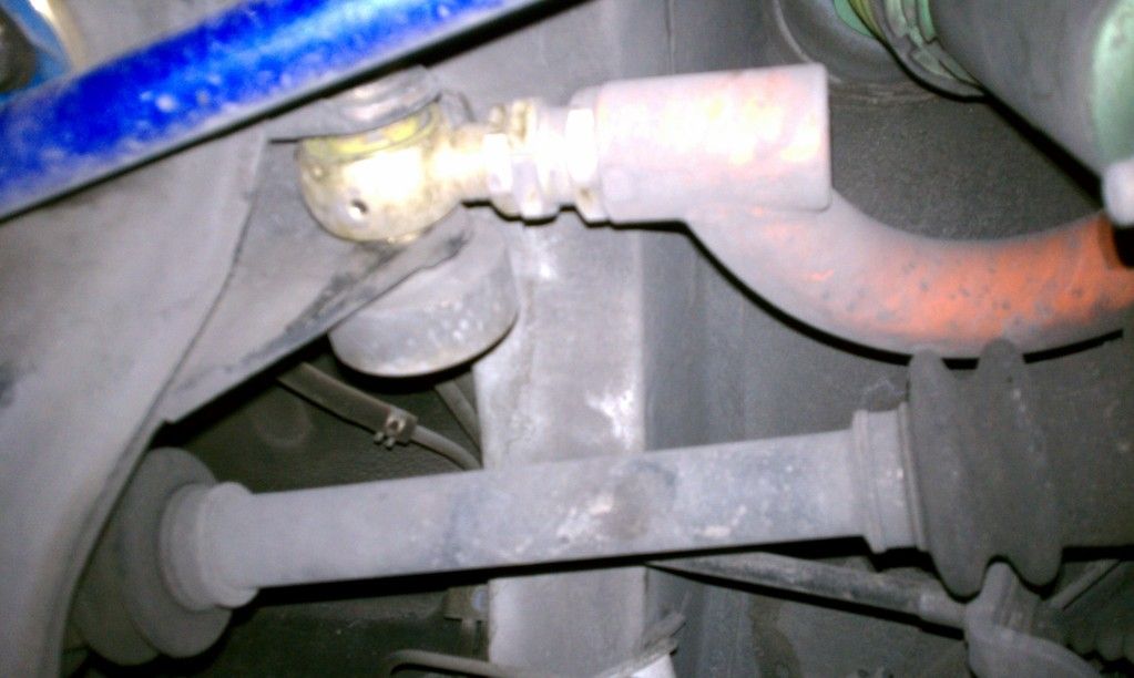

Here is a pic of another members RUCA adjustment. Now when he went with the PBM knuckles he got some of that adjustment back. As seen here...
Adjusting the arms out so far made me leery as well. Most aftermarket arms are shorter than OEM, but can be adjusted out. I made custom arms for my friends drift car that start at OEM length and adjust out from there. Also I am working on a lower arm for his car.

Notice has there's 3 nuts at the end. The middle one is what adjust it. The RUCA is basically 3 pieces, the body, the adjustment and then the heim joint. When you spin the middle adjustment, it pulls out of the RUCA body, the heim joint piece threads out too. The whole section extends out evenly. The outter 2 nuts are the locking nuts to keep it from spinning.

That's how mine are, you turn the center piece and the outer pieces go in or out evenly. I can get positive camber with mine and my car is most likely a lot lower than yours. You will be fine.

Here are the ones I built.
Here is what happens if you throw a Lexas SC300 at them.
Also in this pic you can see how much shorter this NAMs RUCA is than the OEM.

not trying to ride the fanboy wagon but my PBM RUCA got alot to go. last time i did the alginment i had 1.3deg of camber in the rear and they still had plenty to go. definitely could have got 0deg.

Like stated above, the inner part should thread out as well. The green subframe car looks like it has not well made RUCA's. Even my Ebay RUCA's had the second nut to bring the threaded part further out.
