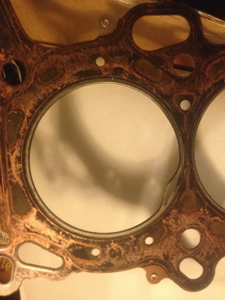

ok so i took my 97 kouki with an s14 sr20det that i rebuilt to tune and for one the new t2871rs t04s housing .86 exhaust turbo was only boosting 16.5lbs of boost with my tru boost set to 80% so i made 393hp 364ftlbs of torque to the wheels. I drove the car about 15miles after the tune it was running beast, i tuned out of town so I loaded it up on the trailer and brought it the 100mi trip home I unloaded it let it warm up for about 10mins drove down the road, opened it up in first to the redline let off and stopped about 1/16 of a mile down the road at a buddies house. He wasnt home so I reversed out of the drive way, as i reversed there was a white cloud of smoke that came out of the exhaust and covered the whole car so i drove it forward and turned it off, tried to start it again and it stopped got stuck pulled it home pulled the head the next day and this is what i found

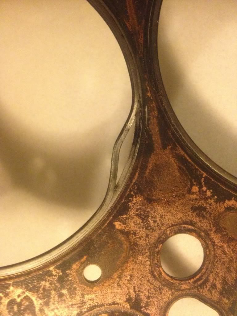

Apexi multilayer headgasket wtf
gave on #1 cylinder

You said it got stuck, as in the engine would not turn over? Were any of the cylinders filled with water? Mine did that, and 2 of the cylinders were filled, the engine tried to hydrolock. Luckily I was able to get it free with no damage to the rods or pistons.
Anyways, while I had a cometic gasket, and the ring around the cylinder didn't do what yours did, when my engine did this it was the only time I ever sprayed the hg with that copper spray. If the tops of the pistons and the cylinder walls check out, replace the hg without spraying it, run it for a little while and do a compression test. That will ensure that there is in fact no further damage.

yea it wouldnt turn over it "hydrolocked" im guessing but i pulled the plugs and tuned it over and it turned over fine, #1 was the only one with coolant in it and just a little. the walls look fine no scratches or scoring at all. i also sprayed that copper crap on it before i installed it, could that be the issue? what hg are you running now?

i don`t think cometic head gaskets have a fire ring around the bore holes, but i could be wrong. that fire ring coming off the side is probably caused by detonation or warped head surface. check the head and block surface for straightness and also check the stud holes on the block around that cylinder and make sure they are not stripped. good luck, i hope it`s something simple and not too expensive.

I just ordered a new cometic hg and they do have a fire ring also just a different design, as far as the head I had it decked and I haven't used the car much after that drove it probably about 400 mi. I also ordered a new set of arp head studs and bc valve springs since im in there the block seems to be straight. Maybe the tune caused a pd?

As of now I'm on an oem HG because I got a new motor. But after that I just ordered another Cometic and it was fine. For the price, Cometic is good. But when I inevitably go metal hg with this motor I'll be going Cosworth. Your situation sounds exactly like mine so hopefully you get off with just needing the head gasket.
As for the copper spray, I sprayed mine right before installing it as well. It wasn't til afterwards that I read that Cometic says not to use it because their gaskets have an extra rubber like coating to ensure a proper seal. I'm assuming your head and block were properly decked before going with a metal headgasket?

actually i ordered a new cosworth hg sorry, the head was decked properly and i checked the block for clearances and it was within spec. i also sprayed the copper onto the apexi, i manually cranked the motor and everything seemed fine. i have wiseco piston heads and eagle h beam rods so i think they are ok. i checked the cylinders and no scoring or anything im going to pull the motor to pull the oil pump and set mechanical timing correctly.

Well I wish you the best. Like I said, after that happened to me it was fine. The motor ended up blowing but for completely different reasons.

Personally, I've had both headgaskets. I ran the Cosworth for a few months, then I tossed a rocker arm. Great headgaskets and they seal awesome, however my only gripe with them is that they don't have the fire ring. If you're pushing big power you want that ring to help prevent possible damage to the block/head. Either way, do not use a Cometic HG unless both the head and block have been freshly decked.
OP make sure you flush your motor extremely well do get all the H2O out.

did you happen to have the front cover decked as well? the front cover on sr's are known for causing cylinder #1 blowouts once you start uping the boost. just something for you to look at if you didn't do it already.

Well if you had the block decked, that means the surface was taken down a little, so the front cover needs to be taken down to match. With that said, When I had my block decked I didn't think about the front cover, but I never had an issue from it.

no even from factory the front cover is barely higher and when you run metal headgasket it doesn't seat 100%. sometimes you can get away with it and sometimes you can't. but this only generally causes #1 cylinder to blow out.

Take a ruler, knife, something with a straight flat edge and slide it along your block towards your oil pump cover. If it catches a lip, you need to have it addressed.
