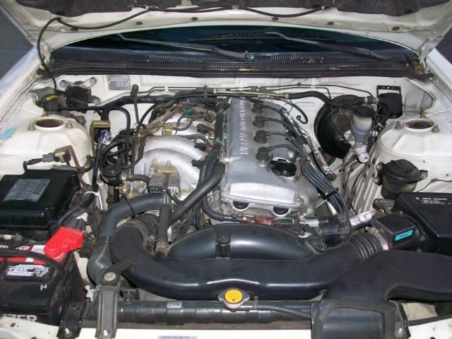

Here's an engine bay pic of my car:
By the upper left, I believe you mean the unit under the Silver VIN badge?

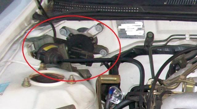

EDIT: Here's a better pic
This wouldn't be the ABS would it?

yup, no ABS in your car
