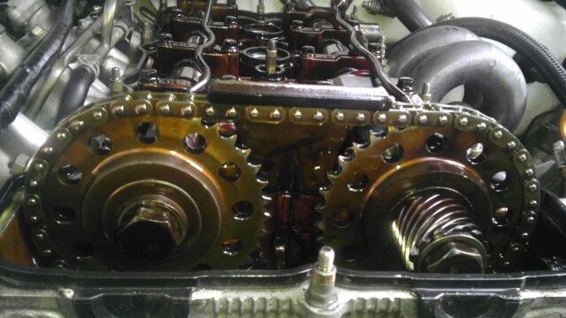

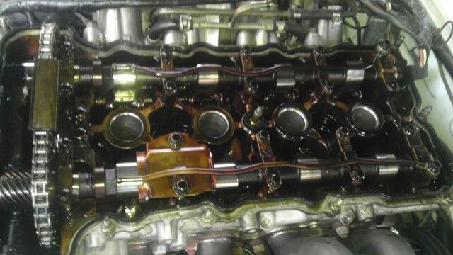

Took valve cover off timing chain is tight no play at all I will post pox in few minutes

Old 09-10-2013, 08:48 AM   #16
typhoonslippery
typhoonslippery's Avatar
Join Date: Nov 2003
Location: Canada
Posts: 812
typhoonslippery will become famous soon enoughtyphoonslippery will become famous soon enoughtyphoonslippery will become famous soon enoughtyphoonslippery will become famous soon enough
check to see if a rocker popped off or broke

Dj6287 is an unknown quantity at this point
Rocker arms all look good I'm starting to wonder if it is even tick in the head unless its the lifters

Your valve train looks horrible! I'd clean that just because!
Now here's what you need to do, take your finger nail and run it across the cam lobes. Is there a lip on either side of the lobes, where the rockers arms sit? If so get new cams, problem fixed, I'd also have the head hot tanked and bathe all hardware. You probably starved the head of oil.
Tip: change your oil, and filter more frequently!
Cam lobes seem fine didn't.feel any lip unfortunately Igot a call and am going back to work after being.laid off for 2 months so am just gunna cut my losses and sell it and take best offer I get for it due to not having.the time now thay I'm back to work so anyone in nj that's interested is more then welcome to come take it for right price 609-312-3850
