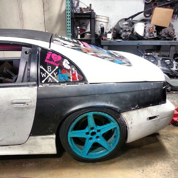

So you're going to slice and dice up some S14 stuff and make a mold for the rear quarter, or...?

That s14 1/4 looks all wrong haha good luck with the repairs.

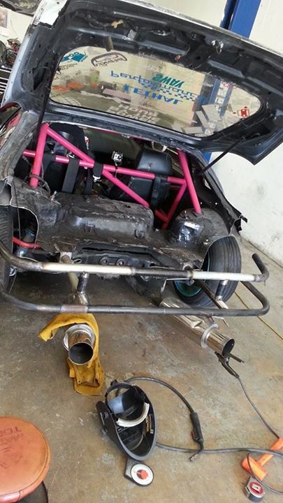

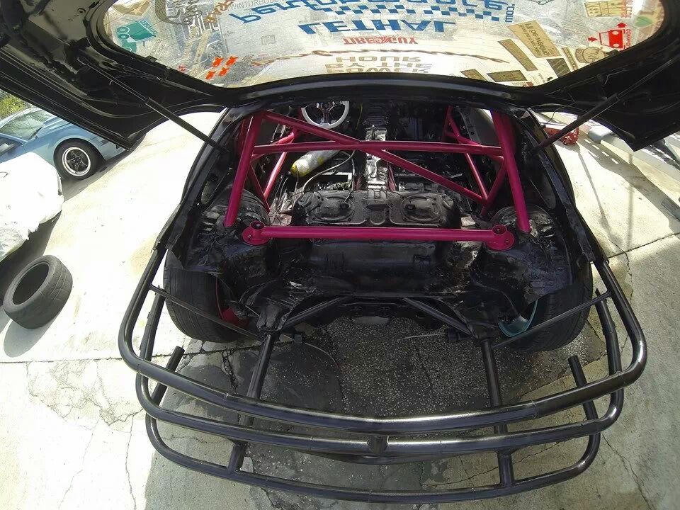

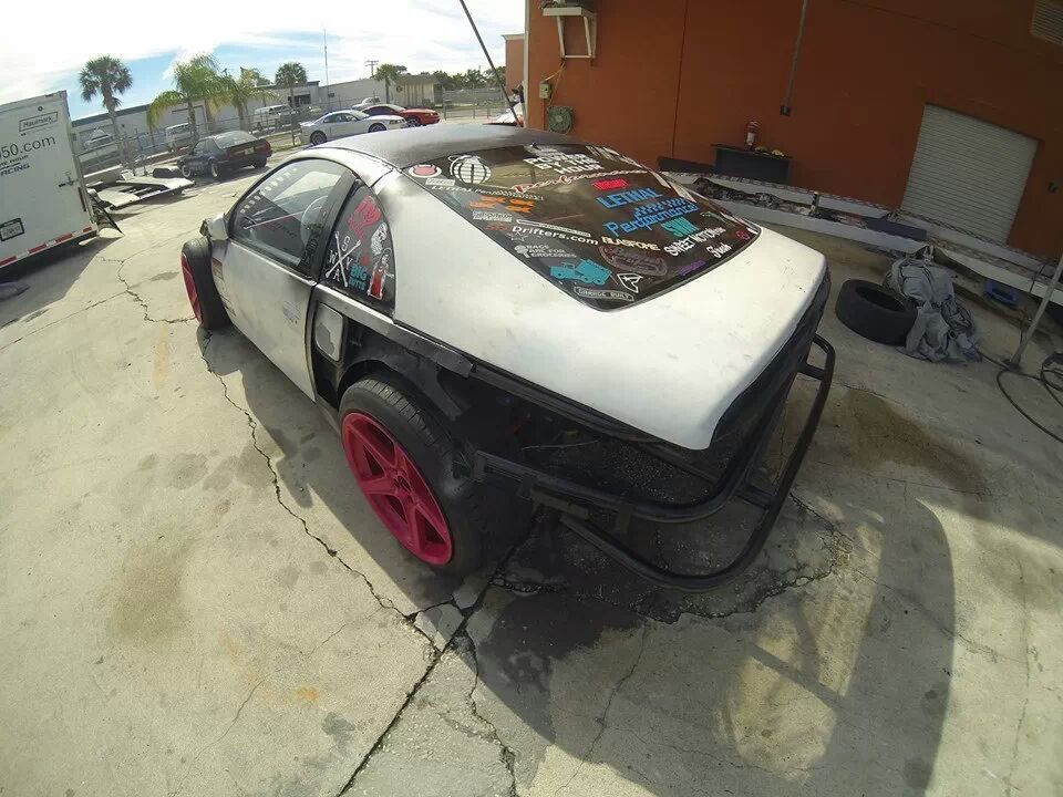

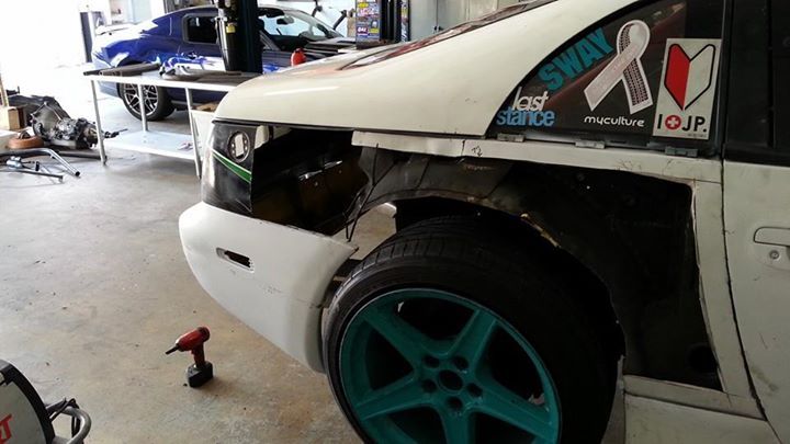

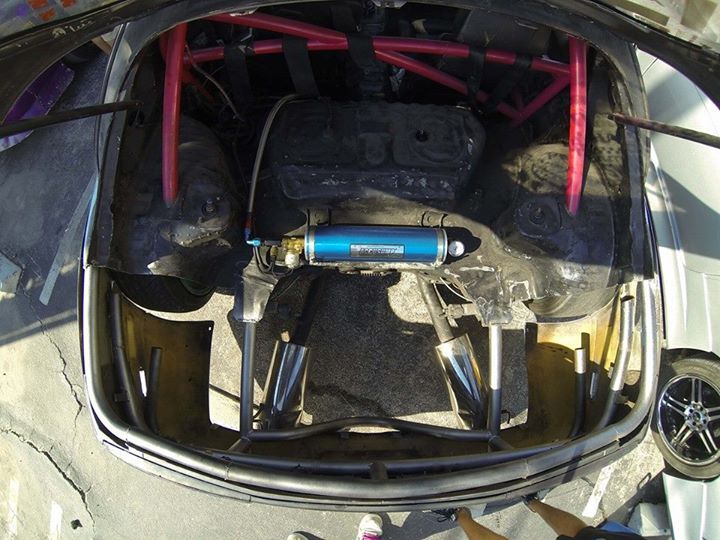

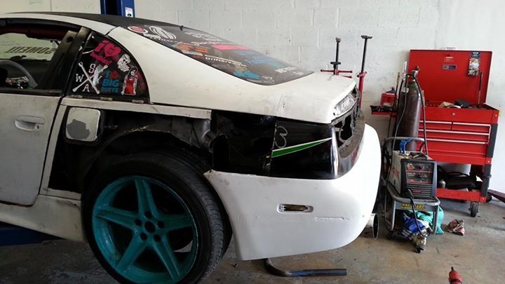

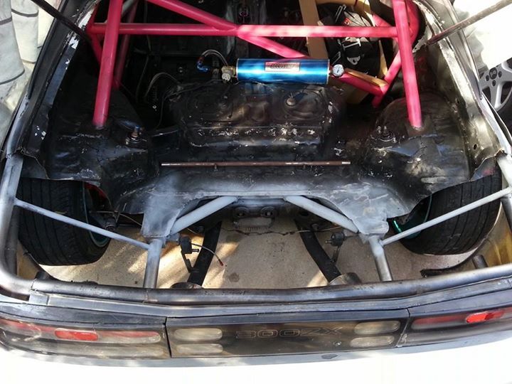

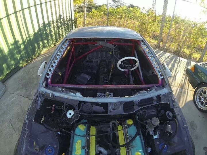

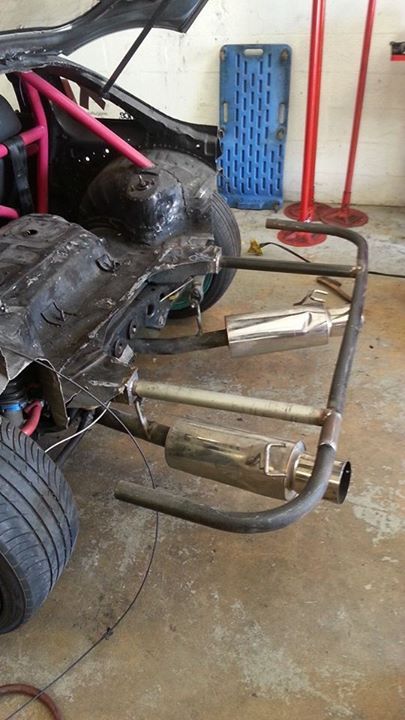

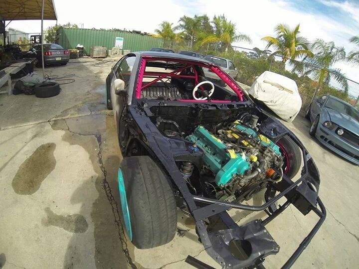

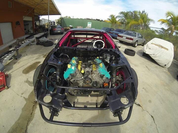

Sorry guys! I didnt even notice that the threat went through!, Here's the latest!

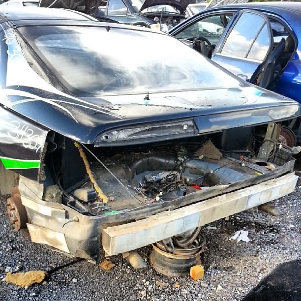

The wait is over. I wanted to have a little bit more progress before I posted up but I've been busy with some other things I havn't had time so here's the update so far, Next step is to paint the "interior" and the rear re paint the cage and do body work on the fenders, smooth out the factory line that the s14, fill the hole for gas door on the pass side and make a hole on the drivers lol. Then full new wiring and such. enjoi

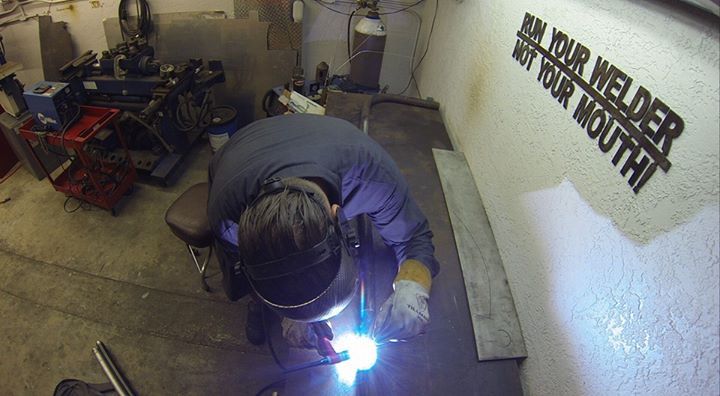

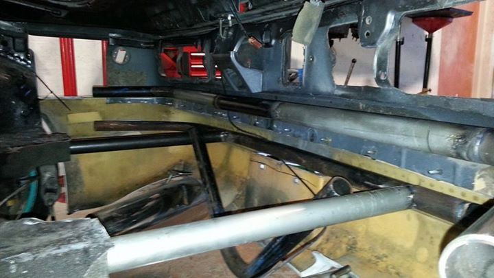

needed a fresh new rear piece so i cut one off of a junk car.

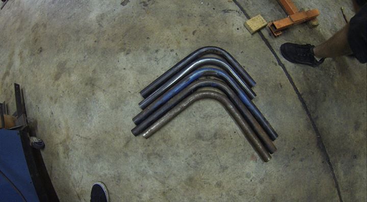

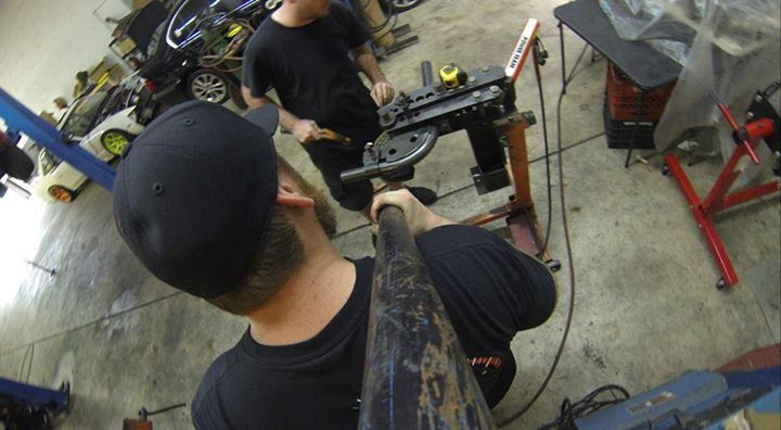

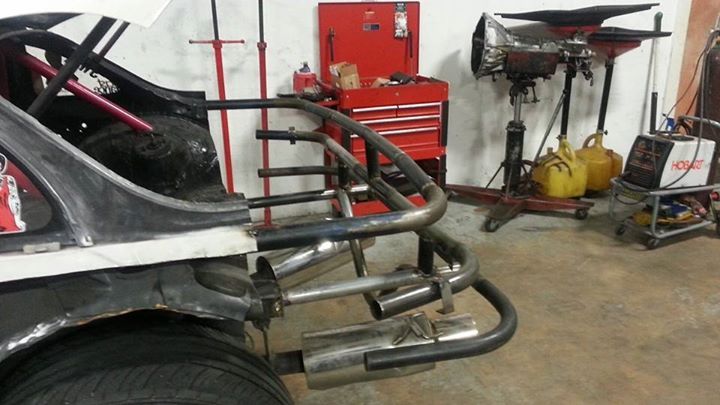

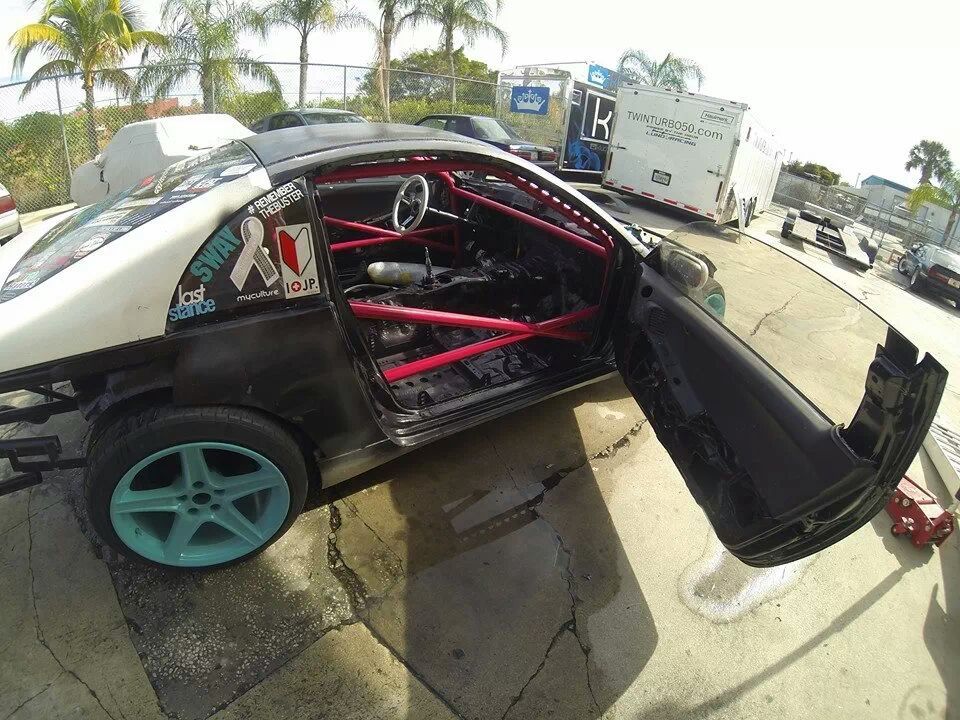

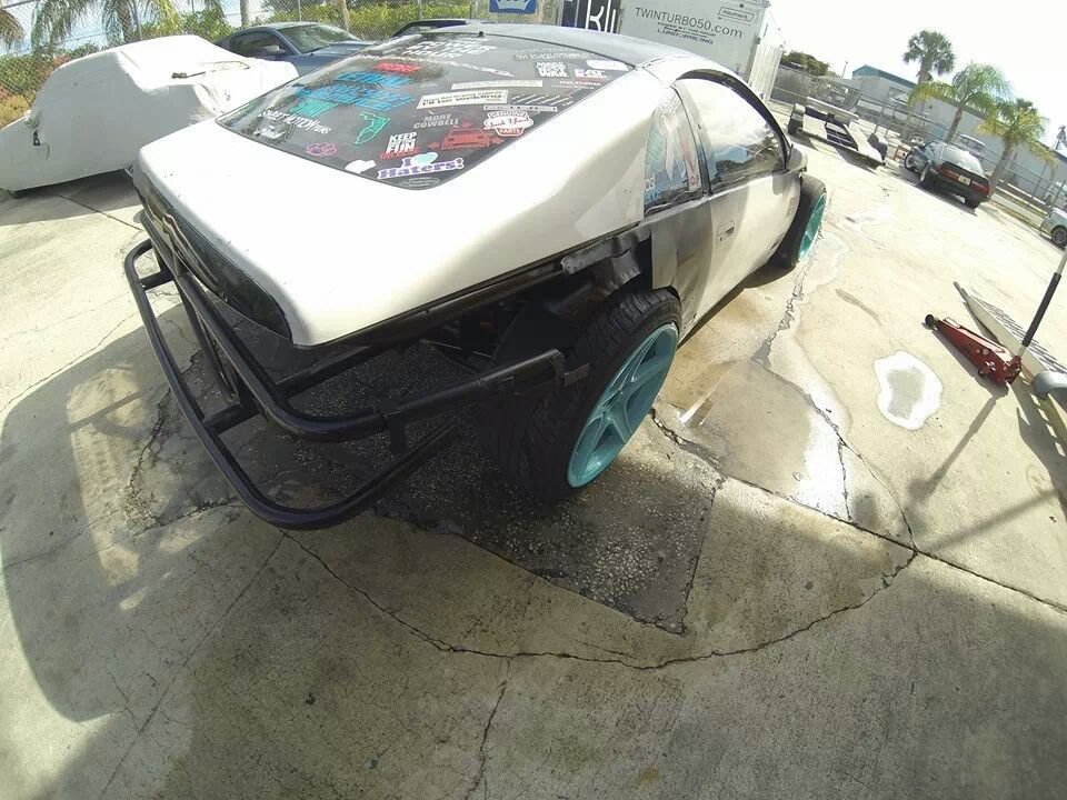

had a friend bend up some pipes
and away we go
took it out for a local show along with my v8 team

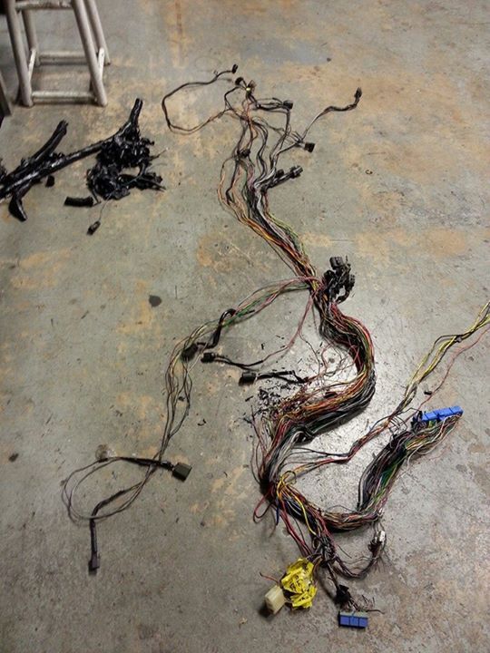

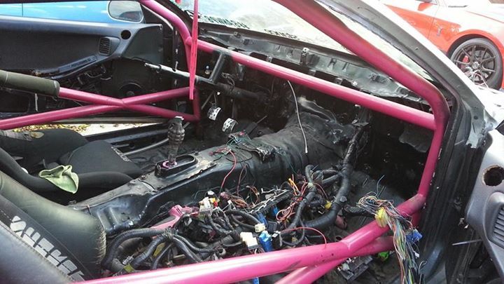

goodbye wiring
cleaning up the engine harness
new handbrake that has been powder coated clear along with my shift knob

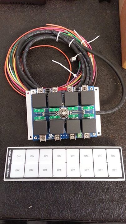

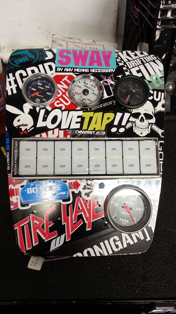

best panel you can get, touch screen switch panel complete with relay board and fuses, super clean no spaghetti

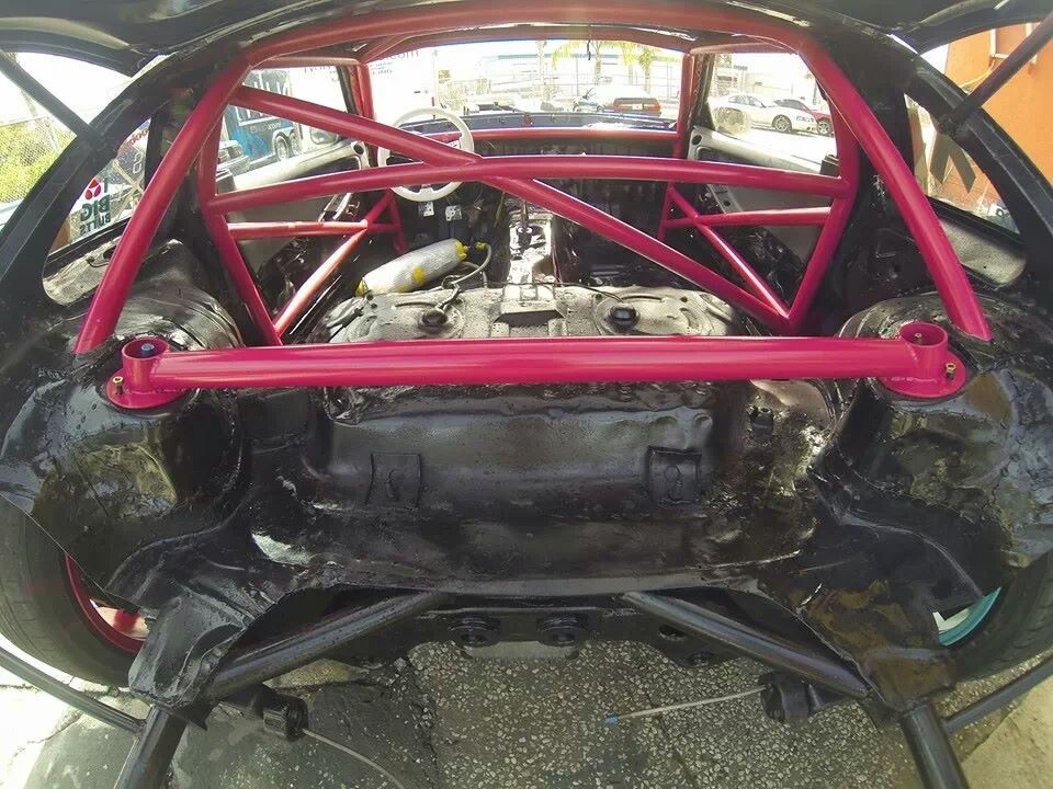

re did the panel and made a bracket to recess the arc panel
Im happy to have an ass again lol contrary to popular belief I hate having a smashed up car, even though this is drifting I like my car to not be shitty. And keep it in mind its not done yet the panel will be riveted in with body work etc. The rear section is fully bolt on and removable I can take it all down to the tubes in a jiffy. Also some of you might think that it needs more bracing but I like to believe that since its a drift car and it will be smashed again that it needs give, since this is a partial tube if you stiffen it up too much it will go towards the weakest link and bend the actual frame or even make you abosrb the impact, I would rather replace a small section of tube.
Mongooze is offline   Reply With Quote
yeah just trim to fit.
looks wrong but its so right lol

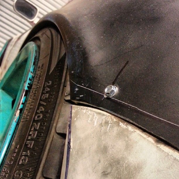

Mission makes overfenders for the Z32. The first set might be expensive to get a hold of but you could make molds of them easier than slicing up that S14 stuff.
yea but but i dont wanna spend millions plus i need something that easy to replace, s14 overs are everywhere.

The switch panel looks pretty rad,
car is looking good btw!

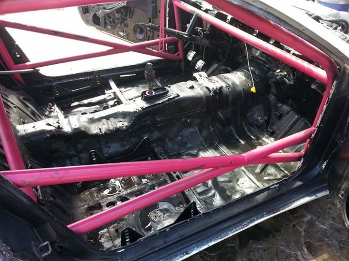

yay updates! really liking the progress. and good evaluation on the tubed rear. if the tubed section is stronger than the frame itself theres nothing to absorb the impact before its dispersed throughout the rest of the car. which could cause some pretty gnarly damage might I say lol. thumbs up man! keep us updated.
exactly! thank you! not only damage to the car but you can also asborb the impact and hurt yourself.

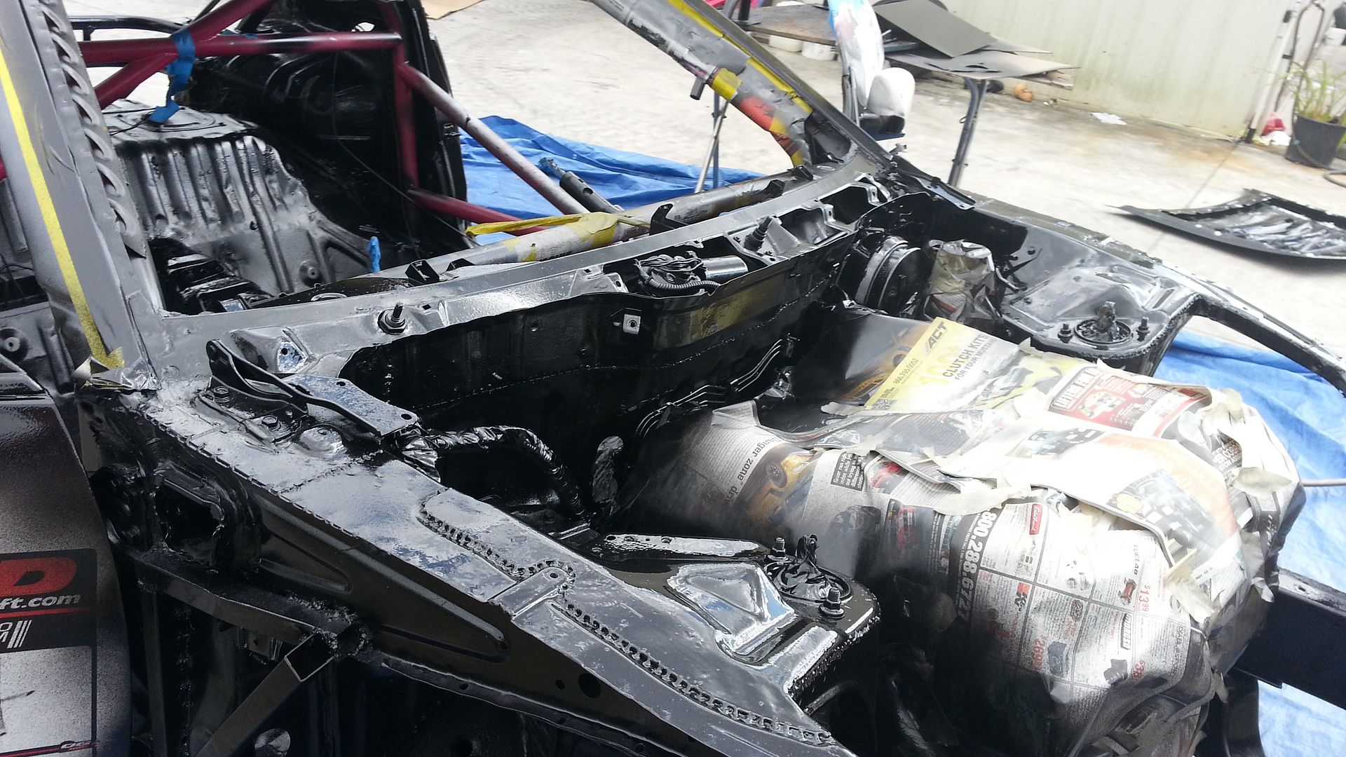

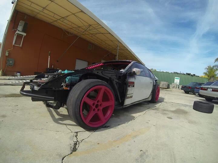

Update: New rad support, strut bar, gussets <3 <3 and Freshly repainted engine bay, roll cage and wheels. Finally time to start putting it back together, Special thanks to Vas for his help on the oh so fun prep work.

Man this thing has been to hell and back, I dig it. Any plans to triangulate the rear tubes more or is it there to strictly hold up the body panels? It looks like it would crumple quit a bit in the event of a love tap, because of the lack of aforementioned pieces.
