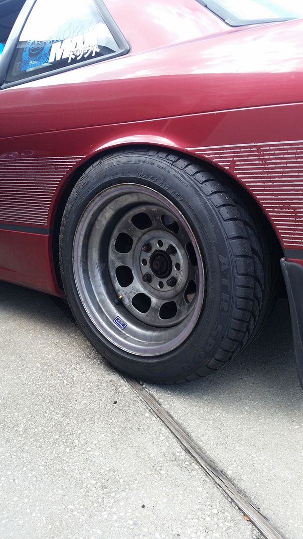

I have a few questions: first I had 235/45/17 on the car (92 fastback) but it rubbed the fenders etc really bad when turning. This is how it looked
As you can see, the wheel gap is very minimal. Since it rubbed, I am getting 16 inch rims to kind of offset that w/o having to raise the car.
My questions are, what would be the best sized tire OVERALL for a 16x8 for tracking/drifting? I'm not looking for stance.. Should the rim have an offset to help avoid rubbing? The offsets come in +20 or +0... What alignment specs would be best?
Thanks

I run 195/55's on 15x8's and it's not much of a stretch. I run the same on 15x9's if I have them, but I try to run 205/50's on them.
Here's 195/55's on my 15x8 et0's
As far as alignment specs for drifting, I keep mine around -3.5* camber 0* toe in the front, and no more than -1* camber 0* toe in the rear. Not only will having only a little camber in the year give you more even tire wear, meaning longer lasting tires, but it also gives you grip which makes more more consistent skidzzz. I run a stock NA KA with lw fw and 248/232 cams and can do third gear entries all day, so the added grip isn't a problem.
