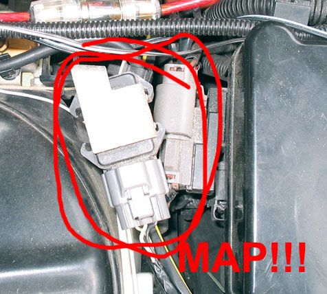

96 240sx ka check engine light is on and the code is map sensor. i went to the connell nissan to pick up the part and he tells me that nissans dont have map sensors they are called boost sensors. so some how i found which sensor it is and there is vacuum going to it should i just get the sensor and hope it works i dunno what to do i need help/ here is a pic of thing

He provided a pic. Thats not a maf.
And you say you got a 96' right?
What is the actual code?

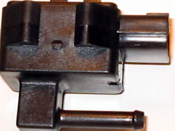

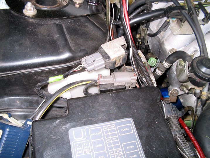

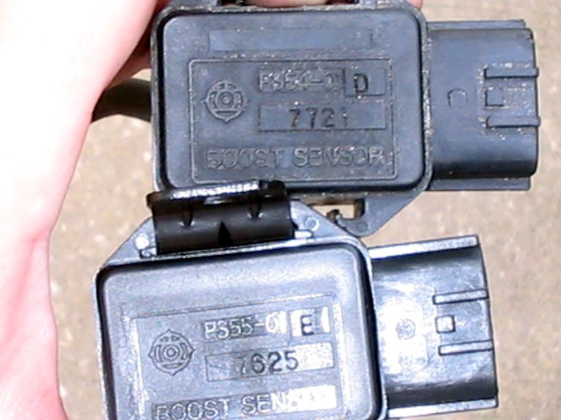

S14's have 2 pressure sensors. One is the MAP and Barometric sensor(the one you are holding). The other is the Evap Pressure sensor.
You have to watch out cause when mine went the parts store and the dealership gave me the Evap sensor rather than the Map. They have a different voltage sweeps and the ECU doesn't like it. It took the dealer a day and a half of tracing to figure it out.
The major difference is in the vacuum nipple. The MAP one comes straight out where as the EVAP has a 90* bend in it. If they give you the one below, don't take it.
